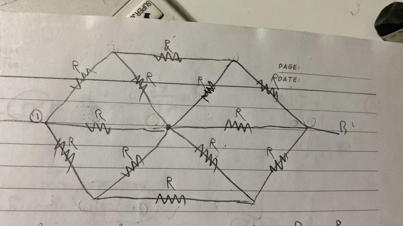

Calculate R_eq in terms of R for the shown figure ...
Kirchhoff's rules.
This problem was sent to me by a good friend of mine. He said that he'd attempted it, but that he couldn't find an answer—at least, not an answer that matched the proposed answer (5/6 * R). So, I attempted it (armed with Kirchhoff's rules) and after a bit of running in circles, I got: 4/5 * R (picture of solution is attached beneath this wall of pre-text. I would have written it in LaTeX, but I neither have the time—revising for finals—or the wherewithal to. Apologies in advance).
What's interesting is I'd attempted it prior and got 1/2 * R as an answer (undoubtly, I must have done something wrong in either—or both—attempt). I come here seeking, what's hopefully, a correct solution I could share with my friend. Much appreciated, let me know if we need to have it written in LaTeX, I will find some time to.

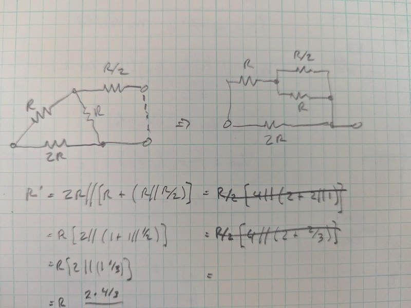

I'm not able to make out the equivalent circuit that you started to write down and scratched out, but were you trying to use symmetry arguments in that line of thought? I'm not great at these kinds of symmetric resistor problems, but can you say anything about what simplifications you might be able to do by cutting the circuit with a vertical line down the middle? Do you see any voltage arguments that may help you to redraw the circuit to make it easier to solve?
Yes, I was.
BTW, you are correct the answer is (4/5)R.

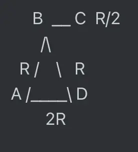

The basic way of using symmetry in a circuit is to carve the circuit up along symmetry axes.
In this case, one axis is ‘vertically' through the middle of the diagram and one horizontally.
Where the cut runs longitudinally through a resistor R, it produces two parallel resistors of 2R; where transverse through the middle of a resistor R, two of resistance R/2.
The top left quarter of the circuit now looks like (sorry, not good at online diagrams):
At the cut through the vertical axis, being everywhere half way along the flow, all points must have the same voltage. This allows us to connect up C and D, making the R/2 (BC) and the R (BD) parallel, so they collapse into R/3.
This is in series with AB, so we collapse those into 4R/3.
Finally, that’s parallel with AD, giving 4R/5.
