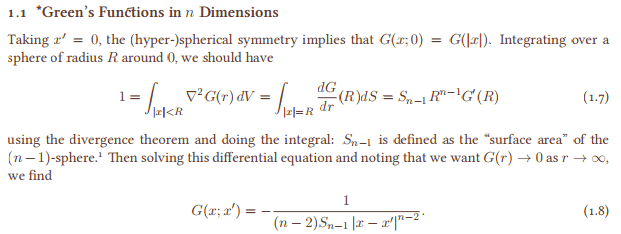

I am interested in the derivation of the inverse square law in various dimensions via Green's functions. I think the trick is to imagine a sphere and then to integrate over it. Does anyone know a book or notes where this is explained?
I found this below from here, but could not really understand what's going on:
Typeset page excerpt titled Green's Functions in n Dimensions, deriving G(x; x') = -1/((n-2) S_{n-1} |x-x'|^{n-2}) via the divergence theorem over a sphere of radius R, equations (1.7) and (1.8).
Is this some theorem that connects the two integrals (Green's theorem possibly?) in (1.7)?
The divergence theorem. (Gauss's law)
