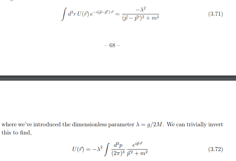

Invert an integral equation to find this unknown
2 replies · 2K views
Replusz
141
TL;DR
I don't quite understand the steps taken to get to the second line (3.71->3.72):
(http://www.damtp.cam.ac.uk/user/tong/qft/qft.pdf)
Apart from the insane habit in physics to write the measure in front of the integrand (:wink:) and other conventions related to factors of ##\pi##, this follows from taking inverse Fourier transforms on both sides of (3.71).
Thank you for your quick and perfectly clear reply! :)
