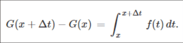

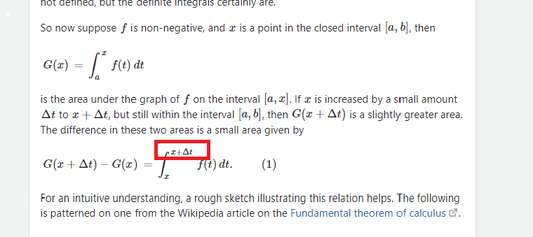

@fresh_42
Thanks, but I have no idea where you're seeing ##\Delta x## as an upper limit in the source. He is clearly stating ##\Delta t## in the upper limit and says:
$$G(x+\Delta t)-G(x)=\int_x^{x+\Delta t}f(t)dt$$
He is constantly using ##\Delta t## in his expressions afterwards. He might as well be considering ##h=\Delta t## based on his given expressions.
Not in your link.
https://www.quora.com/What-does-it-...ariable-in-the-upper-bound/answer/Mike-Wilkes

I see that he used ##\Delta t## which is sloppy and not a good idea. Nevertheless, it is not ##dt.##

Please look at the source carefully because you said I didn't understand the earlier posts and stated the source completely wrong. I did understand it which is why the source's ##\Delta t## actually confused me.

JohnnyGui said:
@fresh_42
The source is wrong/sloppy to use ##t## as a variable outside the integrand. It would be logical to use ##\Delta x## in this case.
I suspect you will find several equally sloppy sources.

So judging from all this I can say that it is wrong/sloppy to put a piece ##\Delta## of the integrand's variable in the integral's limits, if the limits contain another variable.
It is questionable to use the integration variable ##t## indicated by ##dt## under the integral anywhere else.
The integral reads ##\int_a^b f(t)\,dt =\int_{t=a}^{t=b} f(t)\,dt.## This resulted in the equation ##t=x+\Delta t## for the upper bound as used in your linked article. It is disturbing to have the same variable ##t## in one equation but with two meanings! ##t=x+\Delta x## would have been the better choice.
It is further problematic to substitute ##\Delta x## by ##\delta x## or ##dx.## They have different meanings, even in case we consider ##\Delta x \to 0.## The understanding of ##dx## in their various contexts is difficult enough even without adding another context.
