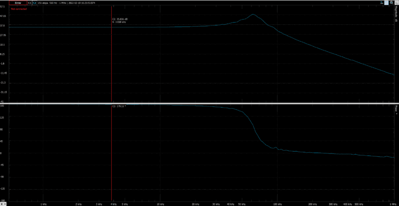

Using analog discovery 2 kit and the bode plot produced by the network analyzer is off. The scope looks fine and everything is behaving how it should except for the bode plot. The magnitude of the bode plot will start at the correct dB then right before tapering off it shoots up a few dB and then falls correctly. I'm not sure what would cause this.

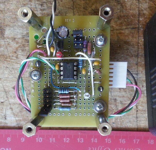

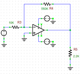

This is the circuit in question. It is an inverting op-amp dutied to produce a gain of 35 dB. Using an input R of 10k and Rf of 560k. Does everything as intended besides this little hiccup in the bode plot. It is a uA741 cp op amp if you want to see the pin out.
If you're not familiar with AD2,
Yellow: waveform gen
Orange: scope ch1 +
Orange/white: scope ch1 -
Blue: scope ch2 +
Blue/white: scope ch2 -
The voltage is all hooked up correctly as well as all of the grounds. The circuits farther down the board (to the right of the picture) all work as intended with this specific amp. I've tried different amps as well.
Thanks
Sorry if it's hard to see in the picture. scope 1 is across the input R, and scope 2 is across the load resistor(2.2k).
The schematic circuit would help. It is so much easier to read than a breadboard. The advantage of the breadboard is that it shows no power supply to ground bypass capacitors, which could easily explain some of the unexpected 741 behaviour.
A 741 can also be externally compensated with a small external capacitor, that may be used to reduce the high frequency gain provide by the manufacturer.

I would do two separate experiments.
1. Place 10 uF of capacitance between each power supply line and ground, very close to the 741. Does that make a difference ?
2. A frequency compensation cap of between 22 pF and 100 pF.
What difference does that make ?
What value works best ?
This is a typical behaviour of closed-loop amplifier with a phase margin smaller than app. 45 deg.
It is somewhat surprising that a 741 type exhibits such a behaviour - I am sure that simulation results will show a rather flat magnitude plot.
Therefore, the mechanical design can be the only reason for this reduced phase margin.
Question: Do you only want to know the reason for the magnitude peak or do you want to compensate it ?

This bode plot looks like a normal 2nd order low pass response. This is the result of two poles created in the circuit. Unfortunately I can't read any of numbers on the plot. So you'll only get a guess for the answer. With accurate measurements from the bode plot you can model the small signal network very accurately.
The first pole is from the limited gain-bandwidth of the 741 op-amp, which you should already know about from reading the data sheet. With a gain of 35dB the amplifier will run out of gain at roughly 20KHz (look at figure 7 in the TI data sheet). You can read about the gain-bandwidth product of amplifiers to learn more about this.
You also have another pole at a nearby higher frequency, maybe 100KHz or so. This is undoubtedly from stray the capacitance of your breadboard*. For a pole at 100KHz with 560KΩ you only need about 3pF.
Anyway, for normal designs that feedback resistor value is quite large. If you reduce the two feedback network resistors by 10-100x you will probably get a more normal single pole response.
*This is why, in real life, analog EE's never use this style of breadboard. Plus it isn't mechanically durable. It's way to easy to accidentally unplug things. Also not very flexible if you have fat leads or tiny parts. This is one version of what our breadboards look like:
