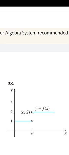

My apologies. I posted the correct problem with the wrong set of instructions. It it a typo at my end. Here is the correct set of instructions for 28:
Use the graph to investigate limit of f(x) as x→c. If the limit does not exist, explain why.
For (a), the limit is 1.
For (b), the limit DOES NOT EXIST.
You say?
For (c), the LHL does not = RHL.
I conclude the limit DOES NOT EXIST.
How is that possible? 1 is not in the domain of the function as x -> 2, just when you GET TO 2.
I think the problem here is that you are using the concept of "limit" when it should not be applied. The VALUE of the function is 2 when x=2. Period.
Yes, but ##\displaystyle{\lim_{x \nearrow c}f(x)=1}##. ##f(2)## cannot be determined.

You should say ##x \to c## not ##x \to 2##. The last one means, that the ##f(x)## is not continuous at ##x=c##. ##f(c)=2## but ##\lim_{x\to c} f(x)## has no determined value, because both possible paths lead to a different value.
We are interpreting the graph in opposite ways. I interpret the black to dot to be a value and the white dot to be empty and you are interpreting it the opposite way. Is there are standard for this?
EDIT: your follow-on post clarifies this
Me, too. But you supposed ##c=2## which hasn't been said.

See my editing work. If f(2) cannot be determined due to the hole at (1, 2), the LHL DOES NOT = RHL. I conclude the limit does not exist.
You say?
You say?
The (two-sided) limit cannot not detemined, ##f(c)=2## can, as can the one-sided limits.
