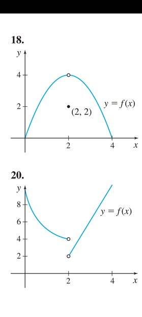

Use the graph to investigate
(a) lim of f(x) as x→2 from the left side.
(b) lim of f(x) as x→2 from the right side.
(c) lim of f(x) as x→2.
Question 20
For part (a), as I travel along on the x-axis coming from the left, the graph reaches a height of 4. The limit is 4. It does not matter if there is a hole at (2, 4), right?
For part (b), as I travel along on the x-axis coming from the right, the graph reaches a height of 2. The limit is 2. It does not matter if there is a hole at (2, 2), right?
For part (c), LHL DOES NOT EQUAL RHL.
I conclude the limit does not exist.
You say?
Mark44 said:
Yes to all.
