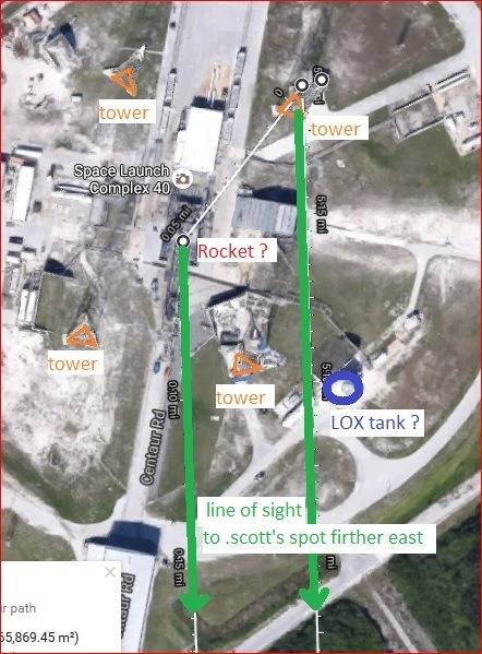

  • #67
nikkkom said:
You can save yourself a lot of time by just reading the thread there.

  • #69
Jonathan Scott said:
