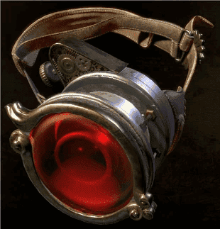

I'm making a prototype of this, also what if there's light shining through the lens

Is this from a game? Physically, the images already show a huge error in the concept.
The lens is red, which means the lens absorbs (or cut out) blue and green light, and only let's red light go through. So there is no chance that you can see a blue light (the second image) through the lens, unless they are upconverted (highly unlikely) or digitally modified.
You can't see IR light no matter what kind of lens you use. You need some sort of device that can detect IR light and digitally convert it into an image.

Unless you have Dave's son's ability to see lower frequencies than the average person, you WILL need an IR sensor and a display device. A simple lens (or filter rather) won't do anything because it doesn't convert IR frequencies into visible light. You might as well use a trash bag as a filter otherwise (this type of plastic is transparent in part of the IR spectrum, but not the visible).
