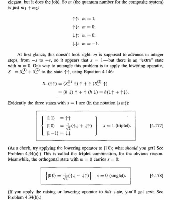

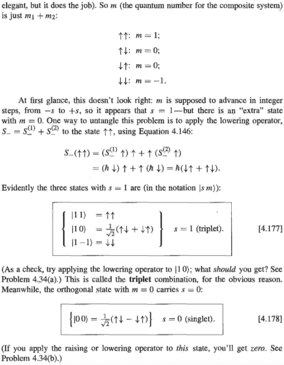

How does entanglement cause a loss of the definite direction? Suppose two free electrons are both spin up vertically. They come together and become entangled. Why aren’t they still remain as both spin up?
Consider a system of two electrons in the state |11> (4.177). Both are spin up. But if I turn my measurement device upside down, then would both electrons be measured spin down? But that state is a different state, |1-1>, implying that I could just change the state by turning my measurement device, an absurd conclusion. But if we take the view that turning the measurement device does not change the measured spin to down, but still spin up, then that spin up is “up” with respect to what, if we can’t take reference to the measurement device?
And for the state |10>, how can the total spin be 1, when it is guaranteed that the electrons always have opposite spins? Is it that before measurement, both electrons’ spin are in the same direction, hence the total spin adds up to 1, but during measurement, the measurement process flips one of the electron spin? But how do you decide which electron to flip? But flipping anyone electron will still seem to make the total spin after measurement become 0 instead. So it’s puzzling how the total spin could be 1.
Consider a system of two electrons in the state |11> (4.177). Both are spin up. But if I turn my measurement device upside down, then would both electrons be measured spin down? But that state is a different state, |1-1>, implying that I could just change the state by turning my measurement device, an absurd conclusion. But if we take the view that turning the measurement device does not change the measured spin to down, but still spin up, then that spin up is up with respect to what, if we can’t take reference to the measurement device?
And for the state |10>, how can the total spin be 1, when it is guaranteed that the electrons always have opposite spins? Is it that before measurement, both electrons’ spin are in the same direction, hence the total spin adds up to one, but during measurement, the measurement process flips one of the electron spin? But how do you decide which electron to flip?
You are getting confused between a state and the description of that state in a given basis.
The state of spin-up in the z direction does not mean that everyone will get spin up regardless of how they choose their z axis.
Likewise, if you change your z axis, the electron remains in the same state. But your description of that state has changed.
As an analogy : If an object is moving along the positive x-axis and you change your axes, then you have not changed the motion of that object, only your description of its motion.
@Happiness I think have several other misconceptions about spin. For example, if an electron is spin up in the z direction, that does not mean that it only has spin about the z axis.
In this respect an electron is fundamentally different from a classical object. A classical object has a definite axis of rotation. An electron never has a definite axis of rotation.
It may be worth understanding the spin on a single electron before studying the spin of a system of two electrons and entanglement.

I don’t really understand this. But are you trying to say that each electron in a two-electron system still has a definite state?
Yes, given the state ##\hat{\rho}## of the two-electron system the state of electron 2 is given by the partial trace
$$\hat{\rho}_2=\mathrm{Tr}_1 \hat{\rho}.$$
It has of course not a definite spin, if ##\hat{\rho}## is a spin-entangled state. As you can easily verify, in a maximally entangled state (i.e., one of the Bell states) ##\hat{\rho}_2=\hat{1}/2##, i.e., the 2nd electron is completely unpolarized.
I’m trying to figure out when two electrons come together and get entangled, which state, |11>, |10>, |1-1> or |00>, the resultant system would be in.
I suspect when two up electrons come together, the system will be in |11>. And two down electrons (down-down overlap) produce |1-1>. Next for the case of opposite spins, there are three ways of approach. Firstly, the two electrons could approach sideways, producing |00> since the head of the spin arrow of one electron overlaps with the tail of the spin arrow of the other electron and cancels each other out. Secondly, the two electrons could approach head on, with heads pointing towards each other (head-head overlap). Lastly, they could approach head on but with tails pointing towards each other instead (tail-tail overlap). These last two ways should produce the same state, the last one left, |10>. They should produce the same state because there should be no difference between heads approaching vs tails approaching, since heads and tails are just labels that could have been swapped.
Next, we could also form superpositions of the system states |11>, |10>, |1-1> and |00>. Consider two electrons with their spin arrow slanted at ##45^\circ##; the left (west) electron pointing southeast, the right (east) electron, southwest. They approach each other, forming a V shape. Since this V is halfway between a down-down overlap and a head-head overlap, the resultant system state is a superposition of their respective mapped states, ##\frac{1}{\sqrt{2}}##(|1-1>+|10>).
The usual representation for a spin entangled pair of electrons is:
##\frac{1}{\sqrt{2}}(|10>-|01>)##
or
##\frac{1}{\sqrt{2}}(|\uparrow\downarrow>-|\downarrow\uparrow>)##
This is also called a singlet state.
No, this is one of the triplet states. The singlet-state ket is
$$\frac{1}{\sqrt{2}} (|10 \rangle-|01 \rangle).$$
It depends on how they are entangled. There are four basis states for the Hilbert space of a two-electron system if we are only looking at the spin part of the state, three called "triplet" and one called "singlet". None of the ones you wrote down are among them; you forgot that electrons are indistinguishable so the spin part of the two-electron wave function has to be either symmetric (if the position/momentum part is antisymmetric) or antisymmetric (if the position/momentum part is symmetric).

I'm using the same notation as 4.177 and 4.178. So according to them, |11>, |10> and |1-1> are the triplet, |00> is the singlet state, and the symmetric or antisymmetric requirement is already taken care of, right?
Ah, ok. Yes, with that notation, all of those states are either symmetric or antisymmetric.
Note, though, that, as I said in my previous post, you still need to take into account the position/momentum part of the wave function (whether it is symmetric or antisymmetric) to know which of the spin states are allowed.

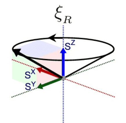

Indeed, the socalled "spin-direction" is actually the axis of precession of the total spin, where the total spin is given by ##s=s^x+s^y+s^z## as shown in the figure below for a single spinor ##\xi##
The three spin vectors ##s^x##, ##s^y## and ##s^z## can be calculated with:

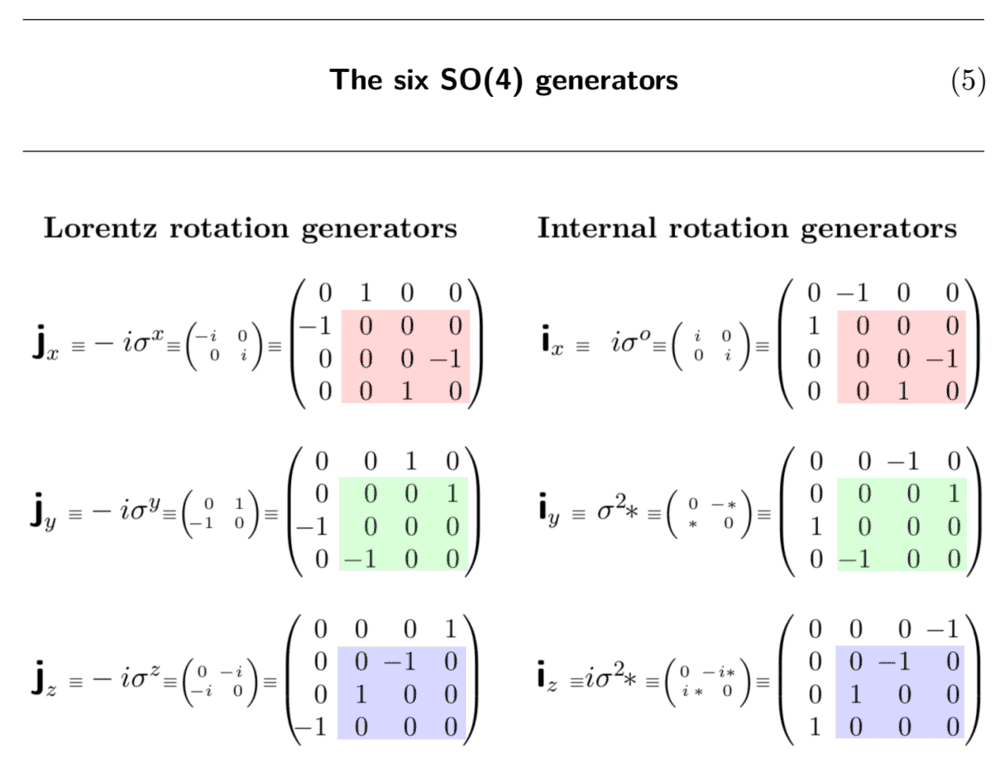

The three ##\mathsf{j}## and the three ##\mathsf{i}## form the matrix representation of the left-acting quaternions and the right-acting quaternions respectively.
Note that the colored rectangles correspond with the three SO(3) generators for x, y and z. Simplifying things again because the ##\mathsf{j_x,j_y,j_z}## are in fact just the three spinor rotation generators!
The standard Pauli matrices are ##\sigma^1##, ##\sigma^2## and ##\sigma^3##. The indices x, y and z in the ##(\mathsf{j_x,j_y,j_z})##, the ##(\mathsf{i_x,i_y,i_z})## and ##(\sigma^x,\sigma^y,\sigma^z)## are chosen so that they correspond with the SO(3) rotation matrices.
With this we now get a very elegant definition of the spinor vectors combining the above matrices into 9 different Pauli matrices using ##\sigma^a_b=\mathsf{i_b\,j^a}## where ##\xi^\intercal## is a row-vector, the transpose of ##\xi##.

$$\check{\xi}\,\hat{\xi} ~=~ (\xi\cdot\mathsf{i})(\mathsf{j}\cdot\xi)~=~\big|\xi \big|^2\!\!\left(\begin{smallmatrix}1~&0~&0~&0~\\0~&\mathsf{X}^{^x}&\mathsf{X}^{^y}&\mathsf{X}^{^z} \\0~&\mathsf{Y}^{^x}&\mathsf{Y}^{^y}&\mathsf{Y}^{^z} \\0~&\mathsf{Z}^{^x}&\mathsf{Z}^{^y}&\mathsf{Z}^{^z}\end{smallmatrix}\right)$$
Here ##\mathsf{X,Y,Z}## are the normalized versions of the three spin-vectors ##s^x,s^y,s^z##. Together they also form a rotation matrix that defines the orientation of the spinor. The spinor operator matrices ##\hat{\xi}## and ##\check{\xi}## are written out as:
$$\begin{array}{c}\hat{\xi} ~~=~~ (\xi\cdot\mathsf{j})~~=~~(u\mathsf{j}_o+x\mathsf{j}_x+y\mathsf{j}_y+z\mathsf{j}_z) ~~=~~\left(\begin{smallmatrix} ~u & ~x & ~y & ~z \\\!\!-x & ~u &\!\!-z & ~y \\\!\!-y & ~z & ~u &\!\!-x \\\!\!-z &\!\!-y & ~x & ~u\end{smallmatrix}\right)\\ \\\check{\xi} ~~=~~(\xi\cdot\mathsf{i})~~=~~(u\mathsf{i}_o+x\mathsf{i}_x+y\mathsf{i}_y+z\mathsf{i}_z) ~~=~~\left(\begin{smallmatrix} ~u &\!\!-x &\!\!-y &\!\!-z \\ ~x & ~u &\!\!-z & ~y \\ ~y & ~z & ~u &\!\!-x \\ ~z &\!\!-y & ~x & ~u\end{smallmatrix}\right)\end{array}$$
Although the matrix multiplication is mine, the result is exactly identical to the Euler-Rodrigues formulaNow ##(\xi^\intercal\sigma^y_x\,\xi)## is the y-component of ##s^x##. There is a very simple geometric explanation for this: The Pauli matrix ##\sigma^y_x## acting on ##\xi## performs a 180##^o## rotation of the spinor around the y-axis and a -180##^o## rotation of the spinor around its own ##\mathsf{X}##-axis. We will explain this further on.
- If the ##\mathsf{X}##-axis of the spinor is parallel to the y-axis then ##~~~~~~~\xi^\intercal\sigma^y_x\,\xi~=~~~\xi^\intercal\xi~=~~~|\xi|^2##
- If the ##\mathsf{X}##-axis of the spinor is anti-parallel to the y-axis then ##\xi^\intercal\sigma^y_x\,\xi~=-\xi^\intercal\xi~=-|\xi|^2##
- If the ##\mathsf{X}##-axis of the spinor is orthogonal to the y-axis then ##~\xi^\intercal\sigma^y_x\,\xi~=~~0##
Now we come to the remarkable fact that the ##(\mathsf{j_x,j_y,j_z})## rotate the spinor around the coordinate axis while the ##(\mathsf{i_x,i_y,i_z})## rotate the spinor in its own local reference frame. There is a relation with the fact that one is left-acting and the other is right-acting. Consider the matrix shown below which corresponds with the (transposed) rotation matrix.
$$\left(\begin{matrix}1~&0~&0~&0~\\0~&\mathsf{X}^{^x}&\mathsf{X}^{^y}&\mathsf{X}^{^z} \\0~&\mathsf{Y}^{^x}&\mathsf{Y}^{^y}&\mathsf{Y}^{^z} \\0~&\mathsf{Z}^{^x}&\mathsf{Z}^{^y}&\mathsf{Z}^{^z}\end{matrix}\right)$$
Acting from one way rotates the columns of the matrix which corresponds with a rotation in the (world-) coordinate system ##x,y,z## while operating from the other direction rotates the rows which corresponds with a rotation in the spinors own reference frame based on the unit-vectors ##\mathsf{X,Y,Z}##.See the sections 1.2, 1.3 and 1.4 of chapter 1 and the whole of chapter 2 here:
To see how QED (1 boson field, 1 fermion generation) can be perfectly extended to the full Electroweak Theory (extra boson triplet and 3 fermion generations) using the Euler parameter representation see here: https://thephysicsquest.blogspot.com/
Well, SO(4) is not SO(3) nor SU(2). The fundamental representation of SU(2) or its extensions via complexification to ##\mathrm{SL}(2,\mathbb{C})## are still the fundamental building blocks of the representations of the proper orthochronous Lorentz group, i.e., one of the fundamental corner stones of the Standard Model of HEP physics.
The representations of the proper orthochronous Lorentz group of course stay the same in the sense that they are replaced by equivalent real matrices.
Note that one can represent all generators of ##\mathrm{SU}(N)## or ##\mathrm{SL}(2,\mathbb{C})## by real matrix generators using the standard replacement of each complex matrix element by a real 2x2 matrix:
$$a+ib ~\longrightarrow~ \left(\begin{array}{rr} a & -b \\ b & a \end{array}\right) $$
So ##\mathrm{SL}(2,\mathbb{C})## is represented by the real matrices ##\mathsf{j_x,j_y,j_z}## and ##\mathsf{i_x}## as defined in my post. These matrices are all square roots of ##-I##. The Pauli matrices are represented by ##\sigma^a\rightarrow\mathsf{i_x\,j_a}## while ##i\rightarrow\mathsf{i_x}## wherever you would typically write ##i## as a simplified notation of ##i\sigma^o##.
But now it comes: The remaining matrices ##\mathsf{i_y}## and ##\mathsf{i_z}## are also used in standard QFT but not recognized as such. They arise when you start using the complex conjugate operator ##*##. For instance in the single spinor Majorana equation which becomes:
$$\Big(~\mathsf{i_x}\partial_t + \mathsf{i_y}m~\Big) \xi~~=~~\Big(~\mathsf{j_x}\partial_x + \mathsf{j_y}\partial_y+\mathsf{j_z}\partial_z~\Big)\xi$$
Without calculation you can now directly see that taking the squares of both sides gives you the Klein Gordon equation:
$$\Big(~\partial^2_t - \partial^2_x -\partial^2_y - \partial^2_z+ m^2~\Big) \xi~~=~~ 0$$
because the ##\mathsf{i_x,i_y,i_z}## also form an anti commuting triplet. Much simpler isn't it?
This is of course well known in the standard representation of ##\mathrm{sl}(2,\mathbb{C})## or ##\mathrm{SL}(2,\mathbb{C})##: The conjugate complex of one of the two-dimensional representations is not equivalent to it. Thus you have two inequivalent irreducible two-dimensional representations, usually labelled as (1/2,0) and (0,1/2). They are known as Weyl spinors. Majorana fermions are represented by quantized Weyl-spinor fields.
The Dirac representation is ##(1/2,0) \oplus (0,1/2)##, i.e., reducible as a representation of the proper orthochronous Lorentz group but irrducible for the orthochronous Lorentz group, including space reflections. In QED and QCD you need Dirac fermions since both the electromagnetic and the strong interaction are P conserving and thus you need to represent space reflections.
