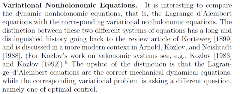

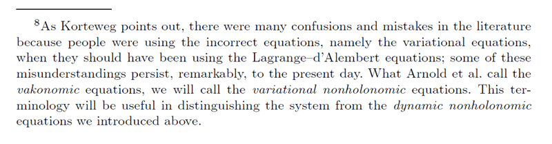

I just stress two things.
1) The problem of minimization of the functional ##A## on the space ##\{x(t)\mid a_i(x(t))\dot x^i=0\}## leads to the vaconomic equations. It is a fact from variational calculus, I have already cited the textbook.
2) In general the Lagrange-D'Alembert equations do not follow from the variational principle formulated in 1).
Both statements are wrong. As I've shown repeatedly in this thread you only have to impose the non-holonomic constraints correctly as a constraint on the (instantaneous!) variations and not in the way of your item (1). I don't understand, how one came to the idea to use (1) as a constraint in the first place since we know since d'Alembert how to do it right.
So I guess, we have to leave it at that and agree to disagree.
it is an interesting story
and from the Preface of Bloch's book:
Well, the book is obviously wrong since as I've written explicitly several times you can derive the correct equations of motion using the variational principle. It's 19th century math.
