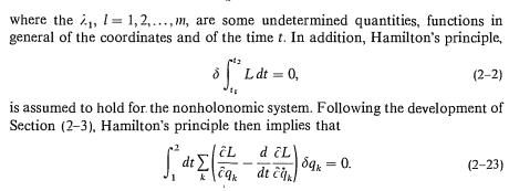

I am using Nivaldo Lemos' "Analytical Mechanics" textbook and on section 2.4 (Hamilton's Principle in the Non-Holonomic Case) he uses Hamilton's Principle and Lagrange Multipliers to arrive at the Lagrange Equations for the non-holonomic case.
I don't understand why it is assumed that the principle of least action is valid for a non holonomic system. On chapter 1, section 1.4, Lagrange Equations are derived from D'Alembert's Principle assuming holonomic constraints and on chapter 2, section 2.3, it is shown that, for a holonomic system, defining the action S as a time integral of the Lagrangian and making it stationary leads us to the same Lagrange Equation, which leads us to state Hamilton's Principle. To arrive at these results, it was needed to assume holonomic systems. However, on section 2.4, the book states that: It is possible to deduce the equations of motion from Hamilton’s principle in the special case in which the non-holonomic constraints are differential equations of the form:​
And the he goes on to use Hamilton's Principle and Lagrange Multipliers to arrive at:
This textbook does kind of "copy" Goldstein's in many sections and I've seen people saying that Goldstein's third editon onward gives incorrect arguments when using Hamilton's Principle for the non-holonomic case, but on the second edition, which I've seen people saying that is correct, on section 2.4 "Extension of Hamilton's Principle To Nonholonomic Systems", in order to arrive at the Lagrange Equations for Non Holonomic Systems he also assumes that Hamilton's Principle holds for Non Holonomic Systems:​
I have actually 3 questions:
1. Can someone please explain to me why we can assume that Hamilton's Principle holds for non holonomic systems?
2. Lemos' books doesn't say it, but do the constraints in eq. 2.66 have to be semi-holonomic?
3. Is there a way to arrive at eq. 2.74 using only D'Alembert's Principle and not Hamilton's Principle?

First of all, that's the correct application, leading to the correct equations of motion, and it's equivalent to the results of D'Alembert's Principle. It's all correct in the 2nd edition of Goldstein's book (I don't know the 1st editition). In the 3rd edition some new authors thought that they had to modernize this great book and by an elementary mistake, they derived wrong dynamics for non-holonomic constraints.
The point is that the non-holnomic constraints are constraints that have to imposed on the variations in Hamilton's principle, and there by definition ##\delta t=0##. That's also clear from the alternative ansatz, using D'Alembert's principle, which of course leads to the same equations, i.e., the Euler-Lagrange equations of the 1st kind for non-holonomic constraints.
I can't answer the question about "semi-holonomic constraints", because I don't know the definition of this term.

Thank you very much for the references, they also helped me a lot with the derivation using d'Alembert's Principle.
So Goldstein's approach assuming that δS = 0 for the non-holonomic constrains of the form:
would only be correct if these constraints are actually integrable, that is only if the constraints are actually holonomic?

This question gets asked frequently here. I understand your confusion because, frankly, the situation is not well explained in many books.
The answer is as follows:
(1) We know the form of the Linear* non-holonomic Lagrange equations from the D'alembert principle (see Greenwod, classical dynamics, p 54) and from the very Newton equations (see https://iopscience.iop.org/article/10.1088/0143-0807/14/5/005/meta).
(2) Hamilton's principle leads to the same equations as before, therefore we say it's good.
(3) In the non-holonomic case, Hamilton's principle is NOT a variational principle (see greenwood again). This is, in the non-holonomic case, there is no action functional $$S=\int L\,dt$$ whose variation $$\delta S=\delta\int L\,dt=0$$ leads to the equations of motion.
Notice that, in the non-Holonomic case, Hamilton's principle must involve ##\int\delta L\,dt## and not ##\delta\int L\,dt##. The equality
$$\int\delta L\,dt=\delta\int L\,dt$$
only holds in the Holonomic case (the proof is somewhere in Pars, a treatise on analytical dynamics). Equation 2.2 from your notes is wrong in the non-holonomic case.*Everything I say here is for the linear constraints 2.66, non-linear constraints are entirely different bests.
