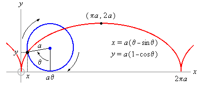

By other work referenced, we know that the solution is part of a cycloid defined by
I believe that equations 1 & 2 specify a cycloid that proceeds above the x-axis from the origin, but the needed path is an upside-down or inverted cycloid that proceeds below the x-axis from the origin.

We now have two unknowns, t0 (the value of the parameter t at X)
There may be an error in equation 4... I think the equation is true for a complete cycloid when you know the horizontal distance between the cusps (except 2xA should simply be xA), but isn’t true when the cycloid is truncated by a certain distance in the y-axis when you know the horizontal distance between the truncated cusps.
I believe xA + X = 2pi * r only when the cycloid hasn’t been trimmed in the y-axis by specifying a range for t other than 0<=t<=2pi
You can flip the sign of equation (2) if you want and work with negative values of ## y ## (and g) everywhere, but the maths is the same if we keep equation (2) as it is and measure ## y ## downwards (in other words flip your drawing upside down).
Devin-M said:
I believe you meant yA=yB instead of xA=xB
I had the right picture in my head and the conclusion is right but of course ## x_A \ne x_B ##. The workings should have been $$ x_B = x_A + X = 2 \pi r - x_A \implies X = 2 (\pi r - x_A) \tag 4 $$
No, for a complete cycloid the horizontal distance is simply ## 2 \pi r ##.
Setting ## x = x_A, t = t_0 ## in equation (1) and substituting it into equation (4) you get
$$ X = 2 (\pi r - r (t_0 - \sin t_0)) \implies r = \frac{X}{2(\pi - t_0 + \sin t_0)} $$ which is exactly what you have in cell C14: =(C3/(2*(PI()-C162+SIN(C162)))).

$$ \begin{align*} x &= r (t - \sin t) \tag 1 \\
y &= r (1 - \cos t) \tag 2 \end{align*} $$
To which we can add ## t = [ t_0, 2 \pi - t_0] ## from the context.
