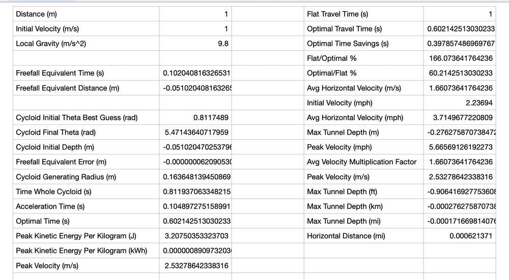

I calculated t (initial angle) and r (generating radius or a) using some logic steps:
https://u.pcloud.link/publink/show?code=kZq8VHXZIECHjF10TLJpQhMs7l1WEROKqDt7
For t, the algorithm first guesses 1 radian, runs it through the A= formula, compared it to the desired depth to determine if 1 rad is too big or small. Then it determines an increment and continues refining until A= is as close to the desired depth as possible after a certain # of iterations...

OK, I see what you are doing. The calculations in the sheet you linked look OK, you could improve this by using the solver to make 'Freefall Equivalent Error (m)' = 0 by adjusting 'Cycloid Initial Theta Best Guess (rad)'.
Bear in mind that the assumption is that the initial velocity is in the direction of the curve (which is pretty steep), not horizontal.
& therein lies the endless task...
Its not an endless task, its an iterative task, and the solver in Excel will do it for you in a millisecond.

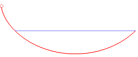

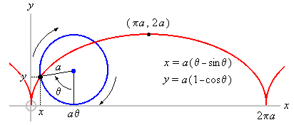

It is probably worth a summary as there have been a few diversions and dead ends on the way.
We are trying to find the shortest journey time between points ## A ## and ## B ## at the same elevation for an object under the influence of gravity constrained without friction to a path. The object has initial velocity of ## v_0 ## in the initial direction of travel, and arrives at B with equal speed.
By other work referenced, we know that the solution is part of a cycloid defined by
$$ \begin{align*} x &= r (t - \sin t) \tag 1 \\
y &= r (1 - \cos t) \tag 2 \end{align*} $$
at point ## A ## we must have
$$ mgy_A = 0.5mv_0^2 \implies y_A = \frac{v_0^2}{2g} \tag 3 $$
and we know the distance ## X ## between ## A ## and ## B ## and that ## x_A = x_B ## so
$$ 2 x_A + X = 2 \pi r \implies X = 2 (\pi r - x_A) \tag 4 $$
We now have two unknowns, ## t_0 ## (the value of the parameter t at X) and ## r ## (the generating radius). There are a number of ways of proceding: the OP (if I remember rightly) has estimated ## t_0 ## and used (2) and (3) to find the corresponding ## r ##; substituted this into (1) and (4) to find the resulting ## X ## and reduced the error by bisection.
