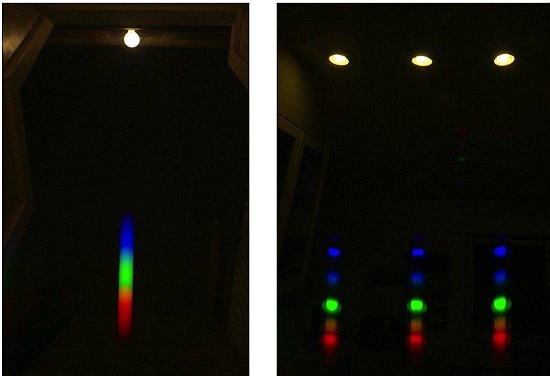

Yes, but not the way you describe for several reasons. OTOH, if you use a dispersive element (like a transmission grating) in the imaging path, you can use the camera as an imaging spectrometer and determine, for example, emission wavelengths of fluorescent lights (Hg), and streetlamps (Na).

sophiecentaur said:
The method that @Andy Resnick suggests would give you a much better result but it would involve using what is effectively a home made spectrometer. That would require quite a bit of skill and ingenuity, I think.
It's really not difficult:
Left is an incandescent bulb, right are compact fluorescent bulbs. The grating is taped to the rear lens element.

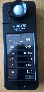

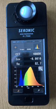

A quick reading with a spectromaster on some 4000K LEDs gave me this data
You don't get chromaticity co-ordinates but you do get the SPD, RA, CCT and lx if that is important to you.

pinball1970 said:
Hi Anand
Just one last thing
Hi-jack a colourist/photographer and have a fiddle with his spectro if you know anybody or hire one from the uni?
Good luck
View attachment 242485View attachment 242486
