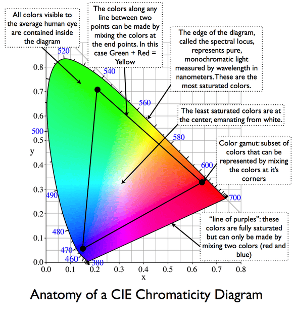

CIE colour space can be represented on the CIE colour chart. The perceived colour of a source can be plotted on the graph below and its xy co ordinates are arrived at by the relative outputs (normalised to eliminate luminance) of the standard human colour analysis (filters on the retinal sensors). A 'blue' hue will be somewhere around (0.15,0.1), for instance.
Annotated CIE 1931 chromaticity diagram showing the horseshoe-shaped spectral locus with wavelength labels from 380 to 700 nm, a triangular gamut with corner points and a line of purples at the bottom.
In normal colour TV, they use three 'primaries' and any hue that lies within the triangle on the diagram can be produced by adding suitable weights of the primaries. Source colours outside the triangle will appear somewhere along the sides of the triangle. Other primaries can be added, say in the region around the greens / cyans and the R signal would be kept at zero to allow the extra phosphor (say at (0.1,0.7)) to 'pull' the resultant outside the triangle. If you want some more details about the calculations, this link could be a start.
In practice, there is little to be gained from adding extra primaries for a tV display because extra phosphors would take up room on the face of the display, limiting the available brilliance or the resolution. The spectra of phosphors are chosen not to be monochromatic but for efficiency.

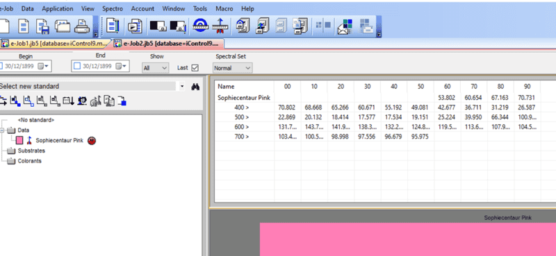

Ok those wavelengths we cannot see but are there should add to the measurement.

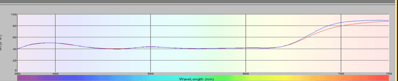

I measure surfaces between 360-750nm but I obviously cannot see that range, my spectro can though.
The standard is stored, a trial measured against it, then values compared at each wavelength, a pass fail is then generated using the reflectance data. Standard red and a trial in blue.
Line graph of reflectance in percent against wavelength in nm from 360 to 750, with two curves: a blue and a red trace that nearly overlap, rising steeply near 700 nm, with a rainbow colour bar beneath the axis.

Screenshot of X-Rite spectrophotometer software showing a table of reflectance values for the Sophiecentaur Pink colour across wavelengths 400 to 700 nm in 10 nm steps, with columns for 00 to 90 and rows for 400 to 700.

I meant, do those values either side of 400-700nm contribute nothing to the overall measurements that go into the Delta E pass fail?
My previous instrument measured between 400-700nm so I was surprised when we acquired this instrument and saw the range. I assumed it was to get the data on the edges more accurately rather than a complete cut off. I will ask the tech who does our annual service.
Knowing what is there rather than just what we can see is useful in terms of chemical composition possibly? Like the amount of oxidized metal on a surface.

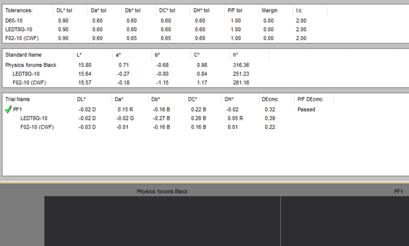

I measured my black bag today and selected D65 as primary, CWF and an LED then measured a different part of the bag for a trial.
The software gives me the colour data in terms of LCH values and trial has the deviations from those values.
As it is the same sample I expected a pass and got one. Not perfect but less than 0.5DE overall which is
very close.
Colour measurement software screenshot showing tolerance table, a standard reference table with L*, a*, b*, C* and h* values for Physics forums Black, and a trial table with DL*, Da*, Db*, DC*, DH* and DEcmc deviations; trial PF1 marked Passed.
