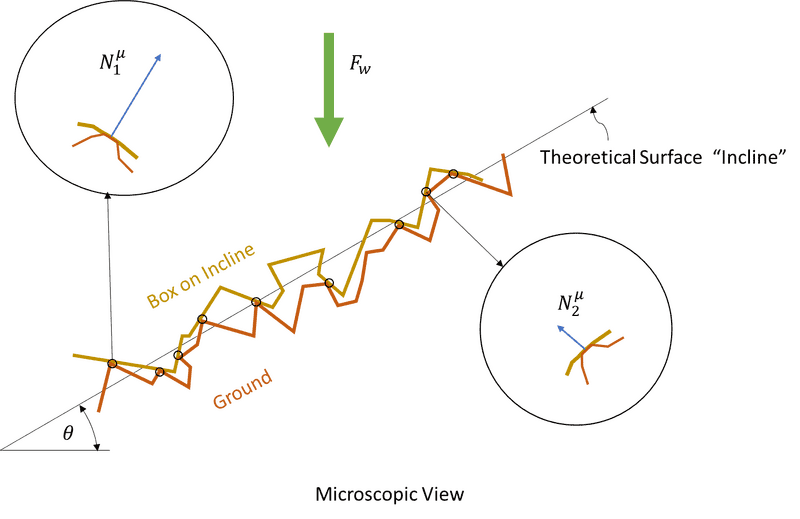

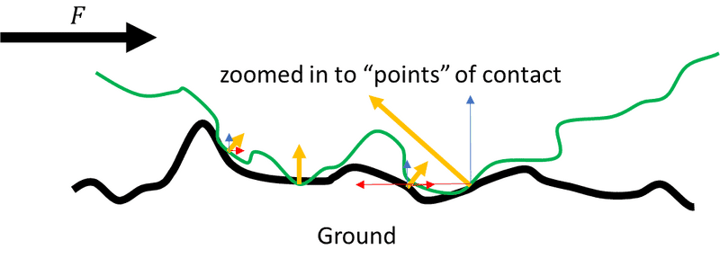

I'm not sure I get the torque aspect just yet, but anyhow... So we can say that the normal force in "smooth world" is the summation of the vertical components of the contact force. So for a box on a rough surface we apply a horizontal force the summation of the vertical components must sum to the weight of the box. If it's not moving as we apply ##F## the summation of the horizontal components of the contact force must equal ##F##.
Can we call this horizontal micro summation of the contacts "static friction"? Is there some particular worry that drives you to specifically "frictional force"?
Something like this: (excuse the reuse of the "wheel curves" for the “box”)
I think well have more contacts (micro Normals) on the left side of hills but...
I'm thinking they either shear off some of these hills (breaking material bonds) and/or “slide/launch” up an over, making kinetic friction the actor. Or am I blind to some nasty combination that needs to happen... I imagine that as the box starts to move forward the contact force components in the horizontal direction could drop.
Could kinetic friction just be the shearing of material from the softer, sending micro chunks flying, and maybe just deforming the harder of the two materials. I'm just thinking that on average the lower horizontal component than "static friction" we observe was the thing begins to accelerate, higher spikes in force-material destruction, but overall far less points of contact because the body is now microscopically bouncing upward overall removing points of contact from the interaction?
Is a separate kinetic friction that is "normal" to the micro Normals even actually there...do we need it in this microscopic view of intermittent material destruction? This is occurring to me after I realize that the jagged and fractal nature of the mating surfaces is far more convoluted/intricate than I give them credit for in my simple illustration.
