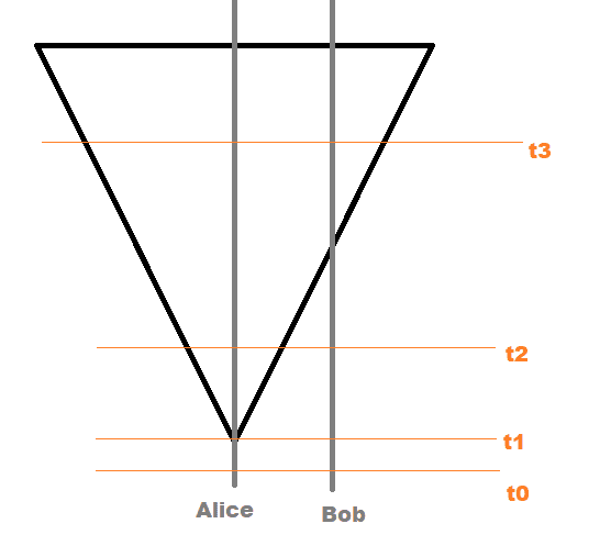

@DrChinese Maybe this approach will be helpful: Light cone diagrams used in Wallace's book, but applied to the entanglement swapping experiment. Shown below is a sketch of a spacetime diagram with two observers: Alice and Bob. Alice and Bob are both using frames of reference that agree on the simultaneity of events (though this is not needed)
At time t0, both alice and Bob say there is no entanglement in the distant [1,4]-photon subsystem (not shown).
At time t1, alice performs an ideal BSM, the light cone of which is shown as the black triangle. This event begins a branching process, and Alice will identify with one of the branches.
At time t2, Alice, identifying with one of the branches, will describe the [1,4]-photon subsystem with a state relative to her branch. She will say there is entanglement between photons 1 and 4. Bob, however, is outside the light cone of the BSM. He will continue to describe the [1,4]-photon subsystem the usual no-entanglement mixed state. He will also describe the Alice + BSM subsystem with a highly nonclassical macroscopic superposition: 4 branches with 4 Alices.
At time t3, Bob will have branched due to the BSM. Like Alice, he will now uniquely identify with one of the branches, and describe the [1,4]-system with a relative state. He will agree with the Alice on his branch that photons 1 and 4 are entangled.
  • #116
More precisely, there will be a branch of Alice corresponding to each of the branches that result from the BSM. Similarly, when Bob branches, there will be a branch of Bob corresponding to each of the branches that result from whatever event caused Bob to branch.
We need to be very careful here: as you state this, it can't be correct.
There are two possibilities: either Bob is entangled with any of the degrees of freedom involved, or he isn't.
If Bob is entangled with any of the degrees of freedom involved, then he branches instantaneously when the BSM is done, because the wave function is nonlocal and all entangled subsystems branch when any branching event affects any one of them. Bob entering the future light cone of the BSM (assuming that information about the BSM result is signaled to him at the speed of light) is when the Bob in each branch knows the branch he is in (because he now knows the BSM result), and updates his model accordingly. But Bob updating his model is not the same as Bob branching.
If Bob is not entangled with any of the degrees of freedom involved, then he does branch when the information about the BSM result reaches him: but then what causes his branching is not the BSM itself, but his observation of the light signals carrying the information about the BSM result, which entangles him with the source of the light. And in this case, Bob is not analogous to, for example, the other photons in the experiment, because those photons are entangled with the degrees of freedom involved in the BSM.
  • #117

  • #119
I agree with everything you say above, but it leaves out the part where Photons 1 & 4 are affected by Alice's actions. That occurs completely outside Alice's light cone. On the other hand, Bob's agreeing with Alice at t3 is simply a result of getting a message from Alice telling him what she observed.
So once you add in Chris and Dale, who at t3 remain outside Alice's light cone and are observing photons 1 & 4 (they can be at the same spot or at different locations), it seems everything falls apart there.
But your diagram is how I understand MWI to work.
  • #120
It's not entirely correct as a description of how MWI works, at least not as @Morbert is interpreting it. See my post #116.
