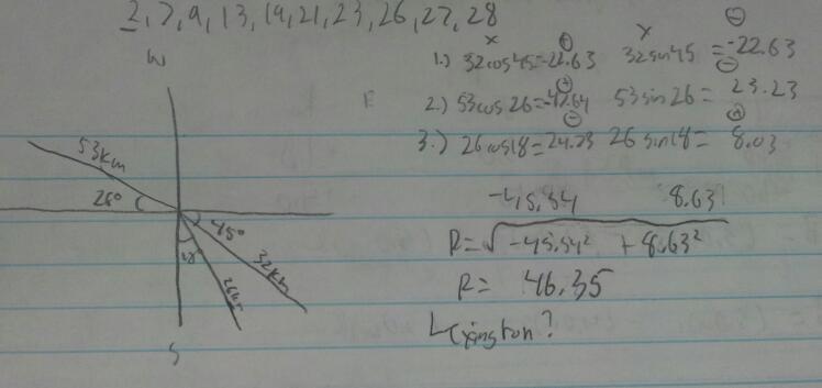

Greetings Fellow Physics adorers,
I was wondering if someone could please help me with the problem attached (I took a picture of it because it contains a complex graphic).
I would just like someone to please look at it and see if I am on the right track to solving it. I attached a picture of my work.
Any and all helps, tips, comments, suggestions are much appreciated.
Thank you!

  • Handwritten vector diagram on lined paper with compass axes labeled N, S and W, showing 53 km at 26 degrees, 32 km at 45 degrees and 26 km, with component calculations and a resultant R = 46.35 written beside it.
ATTN: I think I caught my error.
Should I be using -45, 154, and -72 degrees instead of the ones I used above?
With those new angles, I got my x to be -16.97 and y to be -24.17 and my resultant vector to be 29.53 and my city to be WALPOLE
Why don't you simply add all the three vectors directly? There's not really a need for any such calculations.
Looking at it quickly, it looks like it could be Dedham.
EDIT: At a closer look, Walpole seems correct.

1. Our instructor likes to see all of that worked out like that.
2. Thanks for your comment about the city. I am glad you also think it is Walpole. (makes me feel better inside since I don't have the answer in the back of the book to check :smile: )
