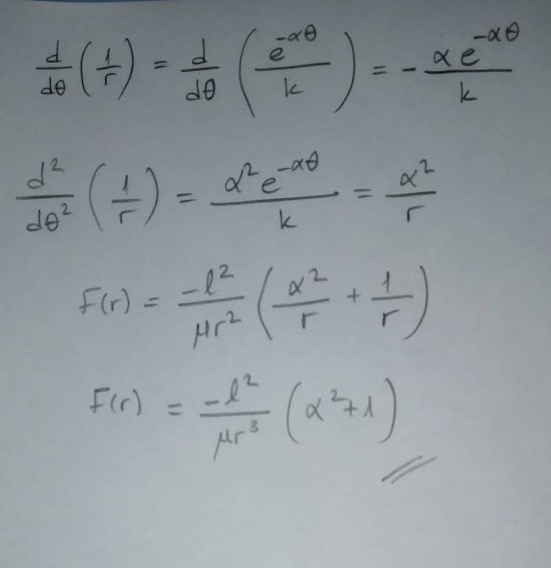

In polar coordinates find the force as a function of radial coordinate F(r) that allows a particle to move in logarithmic spiral orbit r=k*e^(α*θ) , where k and a are constants.
## \frac{d^2}{dθ^2}(1/r)+1/r=(-μr^2)⋅F(r)/l^2 ##
I believe I solved this. Is this solution true? Can please anyone just check?

The force must depend on the speed the particle is moving.
what do you mean, sir? The formula(homework equation) is given like as I wrote up there.
What is the force on an object moving in a circle? It depends on ##\dot \theta##.
The formula has been corrected in the original post. Thank you!
It looks correct to me.
