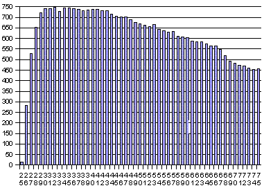

Also, as I noted back in https://www.physicsforums.com/showpost.php?p=2571575&postcount=67":
x axis is 'C, y-axis is watts, ignore T < 30'C per the author.
The temperature of the panels changes their output significantly. I know that when I set mine up in the summer to water the volley ball courts at the beach, you could fry eggs on them.
450 watts/750 watts = 60%
I'd say Artman's panels must be better than my old Kyoceras with only a 30% reduction in output.
Ah ha! You could almost interpolate the panel temperatures from http://www.schottsolar.com/fileadmin/media/us/data_sheets/SCHOTT%20POLY%20220-235%20Data%20Sheet%20US%200510.pdf" :
NOCT 25'C
Power %/'C -0.45
30%/0.45% + 25'C = 92'C
Yup. Probably could have fried eggs on them.

OmCheeto said:
At 40 degrees from horizontal, the panels will be 140 degrees from the plane of snow. They would still catch light at that angle.
Yes, but only diffuse light. Nothing normal to the plane of the panel. So the question is what is the impact of diffuse light. I dunno. Per Artman's results there likely is some impact.

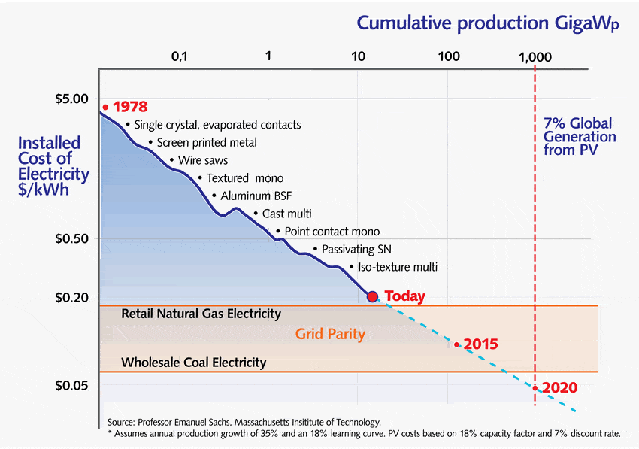

Another http://www.technologyreview.com/energy/24498/" :
According to Harry Fleming, the CEO of Acro Energy Technologies in Oakdale, CA, these changes mean that the cost of a typical five-kilowatt rooftop solar system has dropped from $22,000 after state incentives are applied ($40,000 without them) to $16,000 in the last 18 months. Prices are expected to fall to $13,000 by the end of the year ($25,000 without incentives). "This is going to make solar a middle-class product," he says.
i.e. $2.6 per peak Watt installed, with incentives. About 15 years payback given average US electric rates, even without SRECs.Compared to last year's cost for a 8.8KW system in NJ:
Artman said:
Installed price $74,020
NJ Buy down rebate -$15,400
Subtotal $58,620
Permit fees $500
Subtotal $59,120
Federal Tax credit -$17,736
Total $41,384
Or $4.7 / peak Watt installed. That's a 44% cost decline in 2 years. I smell some kind of Moore's law effect here.
