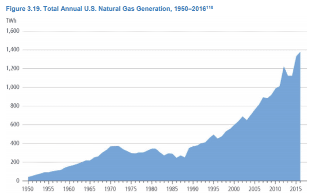

Area chart titled Figure 3.19. Total Annual U.S. Natural Gas Generation, 1950-2016, showing generation in TWh rising from about 40 TWh in 1950 to about 1,370 TWh in 2016, with dips around 1975 and 1985 and a sharp jump around 2012.

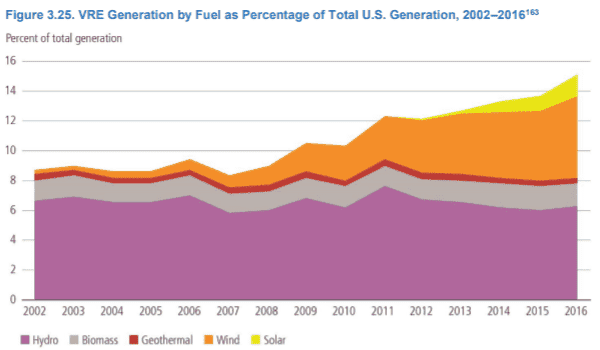

Stacked area chart titled VRE Generation by Fuel as Percentage of Total U.S. Generation, 2002 to 2016, with percent of total generation on the vertical axis from 0 to 16. Layers from bottom: hydro, biomass, geothermal, wind, solar; hydro is the largest layer throughout and wind and solar grow markedly after 2011.

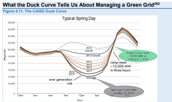

Line graph titled Typical Spring Day, showing CAISO Duck Curve net load in megawatts by hour from 12am to 11pm for 2012 through 2020, with the curve dipping midday and rising steeply in the evening.

But perhaps not to your liking, they also talk about preventing collapse of the BPS (Bulk Power System) If you look at the growth in solar and wind in post #2, you see that they are still small. They are growing as fast as they can. Infinite money and enthusiasm could hardly make them grow faster. The ultimate catastrophe would be economic collapse of non-wind-solar sources before the wind and solar capacity is there to take their place. In other words, we can't sit in the dark waiting for all those renewable things to be ready run run the whole country. That means that those in power must be very careful to look out for the health of every kind existing generation provider.

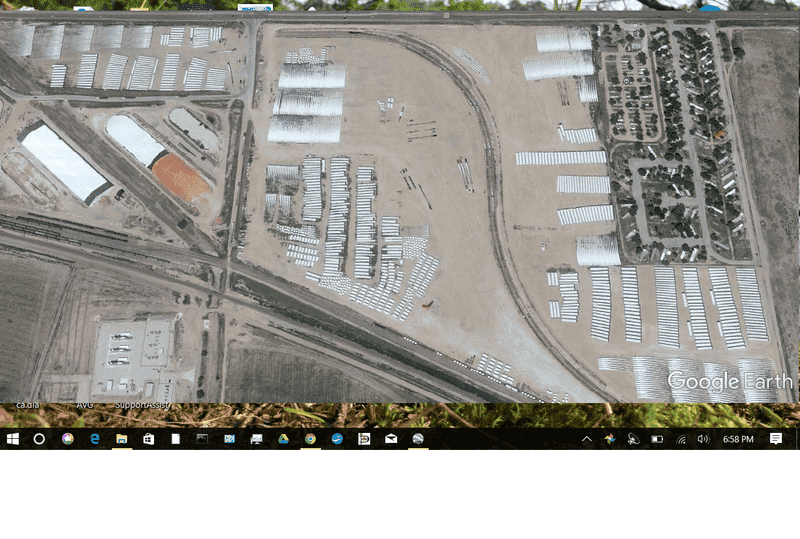

By coincidence, I drove through Garden City, Kansas this morning (see the picture below) and I saw the most fantastic field of wind turbine pylons, nacelles, and blades. It's happening very fast on the industrial scale, but compared to the total electric generation, it seems glacial.
Aerial Google Earth view of a large industrial yard with rows of stacked white pipes or panels, a long curved railway track, and white-roofed storage sheds.
