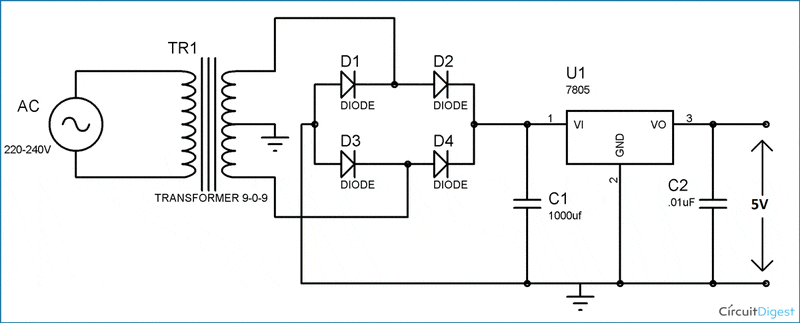

Some, like in the schematic below, try to hold constant voltage. The regulator is the 7806 chip. Current depends on the load, such as a phone. No load, no current.
