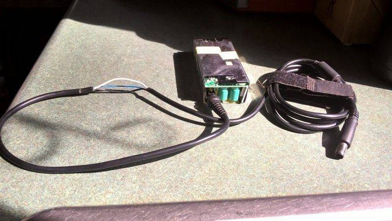

Photo of an open laptop AC power adapter brick on a table, with its black cable split into three colored wires at the left end and a barrel plug and velcro-tied cable on the right.
on my phone so I'm ugh but I want to remove the damaged section and resolder the intact remainder to the pcpu I hope I don't trip!

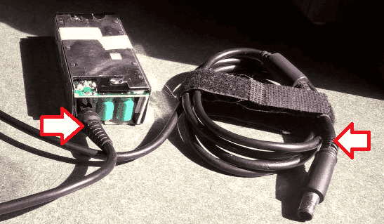

Our breaks were in these two spots
Photo of a black external power adapter brick with a cable running from it, next to a coiled black cable with a velcro strap; red arrows point to the cable end near the brick and to the connector at the far end of the coiled cable.
share what you find ?

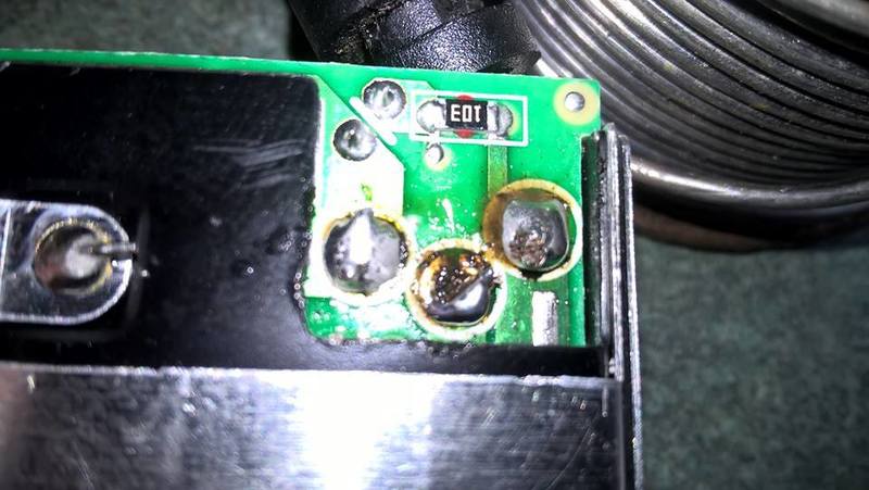

Those pesky little snakes have heads I revamped.
Close-up of a green circuit board with a small surface-mount component labelled EOT inside a white outline, and three large solder joints with circular pads, one with a silvery blob of solder, next to a black plastic housing.
I figured the little blue one in the middle was good enough around the edge of the hole, the wires had what looked like "sticky" conductor clips (perhaps to hold the connections during soldering?) I just held them still in the holes after sanding them until "coppery" looking rather than silver so the solder and flux core works to get a good connection. 15 minutes until full charge!
That's so common on so much gear ... the cable always breaks within or just outside the strain relief section :rolleyes::rolleyes::rolleyes:
seen it over and over again
Dave

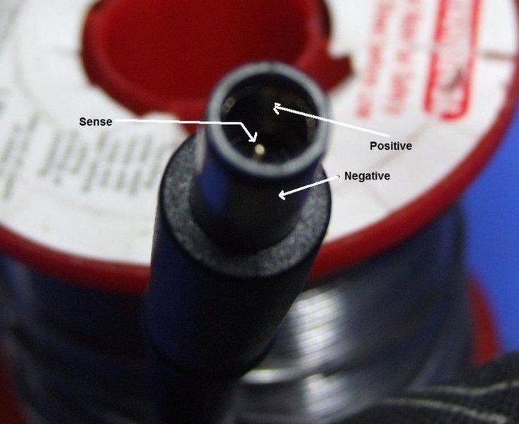

WOW, just learned something !
My HP Pavilion DV6 laptop has been giving the ... "Not a HP PSU" for some time, tho it was still charging OK
and I just had a look at the plug, and as you commented it is 3 separate conductors and the centre pin was bent over,
not connecting and thus causing the error message. A little gentle adjusting and the pin is straight again
a crappy pic trying to get a close up, but hopefully good enough to show
Close-up photo of a laptop power plug tip with three conductors, with labels for Sense, Positive and Negative pointing to the pins and barrel.
Now depending on if they really want to get actual data from the PSU, the sense pin needs to be nothing more than connected to a
resistor to the negative rail and the computer looks for that terminal resistor ... that's the simple and easy wayDave
