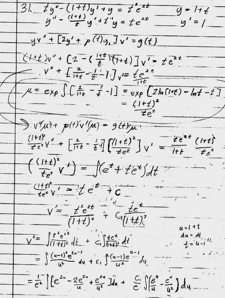

VonWeber Messages 52 Reaction score 0 Thread starter Oct 9, 2006 #1 The problem has ty'' - (1 + t)y' + y = (t^2)e^2t y1 = 1 + t Solve by reduction of order When I solve by variation of parameters I get: y = .5te^2t - .5e^2t + ce^t + d(1 + t) But solving with reduction of order gives very difficult integrals Attachments HW31.jpg 58.5 KB · Views: 2,008
VonWeber Messages 52 Reaction score 0 Oct 9, 2006 #2 Well I should have seen this one (ue^u - e^u)/u^2 is a quotient rule.
