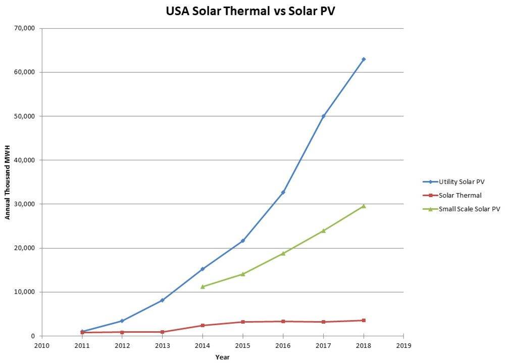

That's a fact, not an opinion, but a very specific and limited fact about a specific and very small project. It does not suggest viability to me without broader context.
Here's how solar thermal has done in the USA, vs. solar PV, over the past 10 years:
https://www.eia.gov/electricity/monthly/epm_table_grapher.php?t=epmt_1_01_a
Graphed:
So to summarize, in 2011 solar PV and solar thermal were roughly equal in the USA, but today solar PV produces 25x as much electricity as solar thermal. The plant you linked produces 110 GWH per year, which would be way too small to show on the graph; it's 1/800th what solar PV produces in the USA.
Perhaps things will change as storage becomes more of a problem (or perhaps people will move away from solar altogether when storage becomes a problem...), but for now solar thermal is a total nothingburger. I can't say I know the details of why it's failed - I'm more concerned with "what" than "why" - but here's an article discussing it:

I mean it is a nothing burger *today*. You can make anything significant if you give it enough incentives. I don't know, though, to what extent it has been incentivized already. I don't know, for example, if the incentives for solar PV apply to solar thermal, but I would guess yes.
