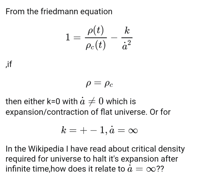

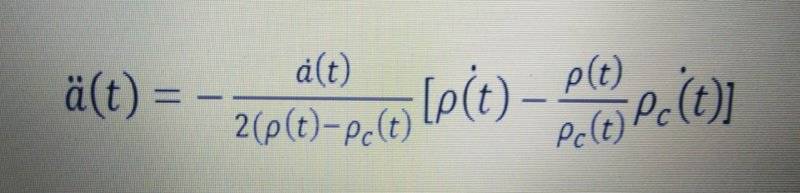

From friedmann equation
And
For a flat universe with k=0 and ρ=ρc ,da/dt becomes undefined and d2a/dt2 becomes 0
But for the present time we know that our universe is flat and expanding with a acceleration (q -ve) ,
Therefore is it here something I am missing??

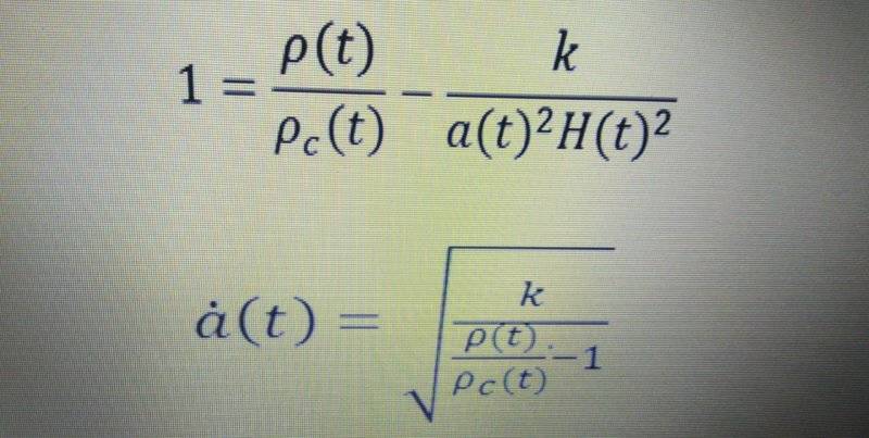

From the first Einstein field equation for FRW metric
3H2+3k/a2=8πGρ,little simplification gives the result posted in #6
Where ρc is 3H2/8πG(critical density)
(From R00-1/2Rg00)=8πGT00
Have you considered the possibility that what your "little simplification" implies is not that ##\dot{a} = \infty## for ##\rho = \rho_c## and ##k = \pm 1##, but that ##k = \pm 1## is not possible if ##\rho = \rho_c##?

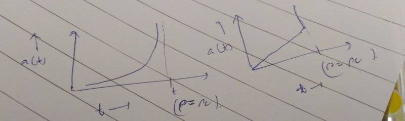

So why is the word 'HALT EXPANSION AFTER INFINITE TIME ' is associated with critical density ??
Is it something related to this
The first one for expansion with acceleration and the second one with linear expansion .
Implies after the time at which ρ=ρc , a is not defined ,is it so??
(It is only for k=+-1,k=0 will allow expansion forever)
I've already given you a strong hint in post #9. You need to go back and re-check the math. It doesn't mean what you think it means.

Is it that for k=+-1 ,at the time of ρ=ρc ,a(t) at that time can't be defined ,that's why it is not allowed ??
But for k=0 ,it will allow expansion or contraction (linear or accelerated) forever...
As you have been told repeatedly, you cannot have ##\rho = \rho_c## without having ##k= 0## or vice versa. The curvature is directly dependent on the energy content relative to the expansion rate.
There is no such thing as ”the time of ##\rho = \rho_c##”. It is either satisfied at all times or it is never satisfied.

Ok if ρ=ρc is satisfied for all times , then for k=+-1 , the scale factor can't be defined...and no question of expansion or contraction or static.
Is it??
Is it??
Really? You are not reading. Reread the statement. You cannot have ##k = \pm 1## when ##\rho = \rho_c## because then ##k = 0## by definition.
