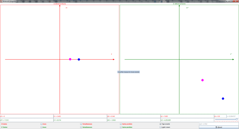

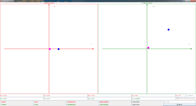

Measurement of track length.
For the spectators the track measurements are taken at a single point in time and two flares are fired simultaneously to prove this.
For the runner, the track is speeding towards him. He sees the spectators first they measuring one end then they fire a flare. A short period passes, during which the tiny track continues to race towards him, then he sees the spectators measuring the other end and then they fire a red flare. For him the the entire track moved between measurements.
The spectators have Proper Distance which is lowest because the track does not move in their frame of reference.
The timing of the race itself. As seen here, for the spectators standing at the start line, the runner moved through time and distance. Whereas for the runner (right diagram) he only moved through time, he did not move through space. Therefore runner has the Proper time which is always the lowest time.
