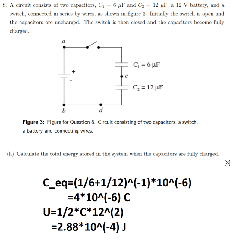

Clara Chung
- 300
- 13
cnh1995: I agree that 0.288mJ looks correct. But I have not been able to see how to support your statement that "the energy supplied by the voltage source is 0.576mJ". Assuming you are correct, is it possible to interpret the assigned calculation to mean the energy supplied by the voltage source?cnh1995 said:Yes, 0.288mJ looks correct.
But the energy supplied by the voltage source is 0.576mJ, and maybe that's what they printed as the model answer by mistake.
Well, it can be shown mathematically, but I don't think this problem requires that.sojsail said:But I have not been able to see how to support your statement that "the energy supplied by the voltage source is 0.576mJ".
