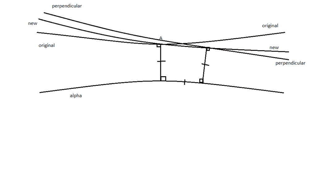

Can we draw another line through the A which is parallel to the α?
For some geometries, yes.
The simple example is a geometry on a surface with constant negative intrinsic curvature -- a sort of saddle shape. On this surface, consider two lines that are locally "parallel" in the sense that they point in the same direction but do not touch. As you follow these lines toward infinity, you will find that they diverge from each other in both directions.
In this geometry you will find that there is a small range of angles for which the lines will still diverge in both directions. [Along with a critical angle at which they will converge without meeting in the one direction and at which they will converge without meeting in the other].
  • Skeptical

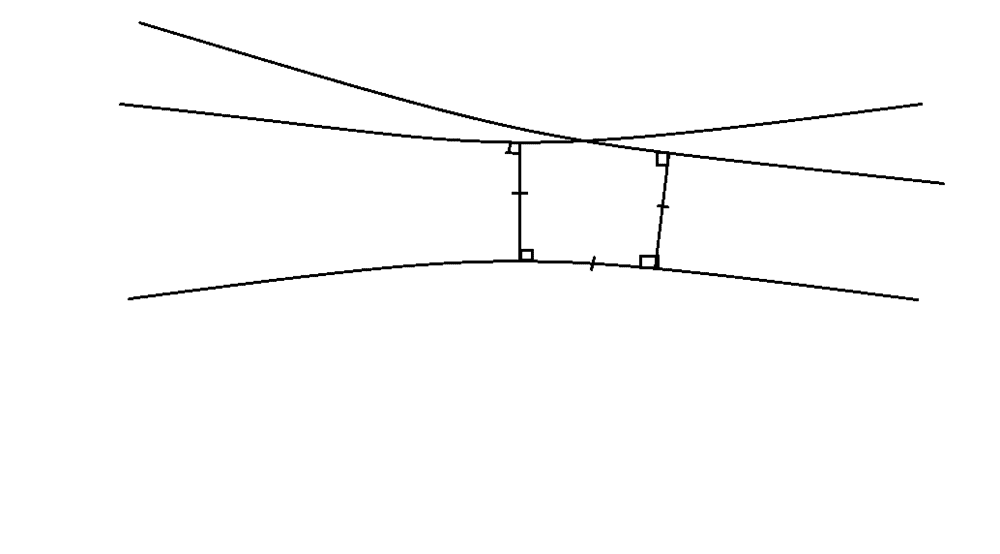

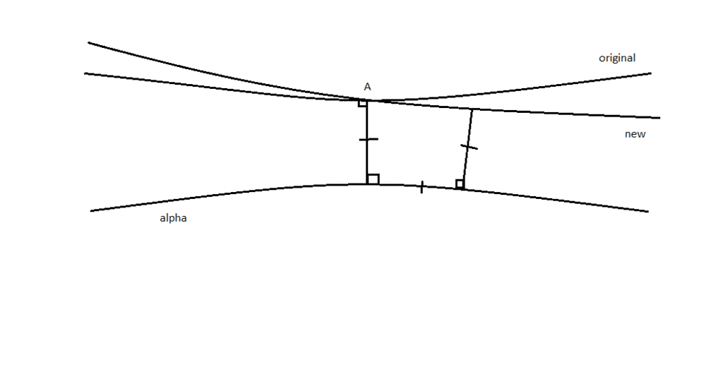

For my construction it is.Could be other constructions produce another line?
Yes. I already spoke about existence. Now you want constructibility.
Perform your construction -- drop a perpendicular from point ##A## to line ##\alpha##. Set your compass to the distance between ##A## and the intersection point of the perpendicular with ##\alpha##. Use the compass to mark of a point this distance down line ##\alpha## from the point of intersection. Draw a perpendicular to ##\alpha## from this point and mark off a point on this perpendicular at the same distance as was set before (and on the same side of ##\alpha## as before). Take the perpendicular to the perpendicular at this point and you have a line that is locally "parallel" to ##\alpha##.
For Euclidean geometry, the new construction produces the same line as the old. For non-Euclidean geometries, such is not assured.
The line is parallel but is not passing through A.
You are right. I got caught up in the mechanics of drawing and forgot the goal. But that is a minor fix.
At the last step, instead of drawing a line perpendicular to the perpendicular, draw a line passing through A.
You can construct a whole family of parallel lines based on where you put the second perpendicular.

You constructed a parallelogram so yes, indeed the "new" line is parallel to α. But it is not a new line.It is the perpendicular.The three lines is the same, the original.

You have failed to understand how locally straight lines project on the surface of a saddle function. The drawings I have produced are accurate depictions and conform to the four axioms but not the fifth.

We are talking about an abstract space characterized by a set of axioms. The fact that you picture a flat plane in your mind is not relevant.
A plane fits the axioms. But so does a saddle or potato chip shape. There is a picture here.
