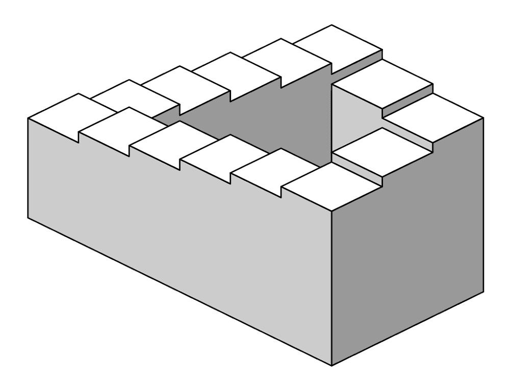

As he mentions in the video, his model was the Escher staircase painting which more of an optical illusion than a true non-euclidean world. Escher's painting was based on Penrose steps:
1024px-Impossible_staircase.svg.pnghttps://en.wikipedia.org/wiki/Penrose_stairs
Based on the description the stairs can't exist in a Euclidean world. However, that doesn't mean it exists in a non-Euclidean world but is rather an illusion of the mind.

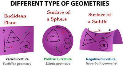

It's almost always the parallel postulate. That's what guarantees that the interior angle sum is the value of Euclidean geometry, and if you violate that you get curved space.
You can also ask what "straight" means in (1), which is an interesting question on its own and leads to different geometries.
Consider the following situation: There is a "strait line" and point which is not on that line.
How many "strait lines" are passing trough the point and doesn't touch the first strait line (parallel to it).
Every part of the "strait line" between two points is shortest path , depending of the space , between those two points.
There are three possibilities :
1. Euclidian geometry
- also known as flat, with zero curvature
- exactly one parallel strait line
- sum of angles in the triangle is 180 degrees
- π is 3.14... ratio
2. Reimann geometry ( German mathematician Bernhard Reimann )
- also known as spherical, elliptic, with positive curvature
- There is no parallel lines / all "strait lines" (big circles) are intersect on opposite sides of the "universe" (sphere)
- sum of angles in the triangle is greater then 180 degrees
- π is 3.14...
3. Lobachevski /Bolai geometry
- also known as hyperbolic, on saddle , with negative curvature
- infinite number of parallel lines (two of them are "hyper parallel" )
