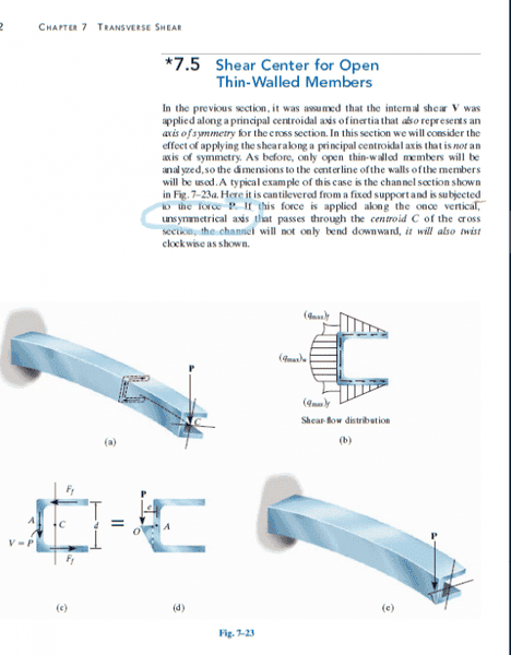

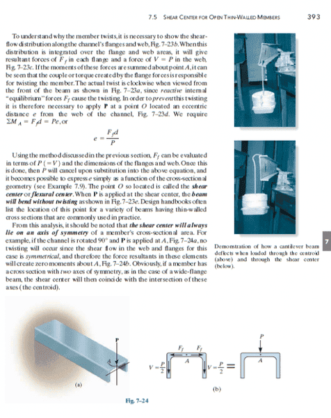

In the figure , we can notice that the moment due to Pe is counterclokwise , but moment due to shear flow is also counterclockwise , How can the Pe prevent the twisting of the beam ?
Or is the direction of the shear flow wrong ? Should it flow from the below to the top ?
  • Figure 7-23 with five panels of a channel-section cantilever beam loaded at its free end: (a) the beam with force P, (b) shear-flow distribution across the flanges and web, (c) shear forces F and V, (d) load P offset from the centroid C, (e) the same beam with P applied off-axis.
  • Textbook page showing a channel beam cross-section with shear flow arrows in the flanges and web, a cantilever beam photo, and Fig. 7-24 with two channel sections labelled P, F, A, V = P/2.
From how I read it: ##P\times e## is the resultant of the shear flow and gives you a distance ##e##, the distance (on the other side of the web!) at which you can apply the actual load that offsets ##P\times e##, thus causing a minimum of twist.
why ? P is the applied force , and F is the resultant force of shear flow, right ?
