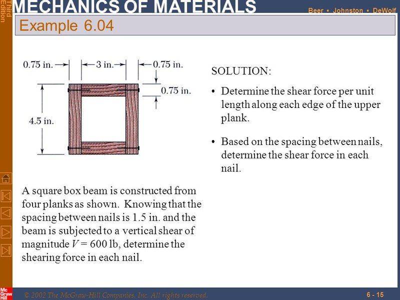

Similarly, I am having trouble visualizing or creating a free body diagram to understand where the horizontal shears on the nails in the box beam arise from shown in attached picture. I can see there would be longitudinal shear stresses if the box were rotated 90 degrees.
Actually, there are vertical shear stresses in the flange also, but they average out very small when spread out over the full flange width , b, from the shear stress formula VQ/Ib, which yields a parabolic shear stress distribution over the flange, but again, rather small, and essentially these are ignored for thin walled sections. The horizontal and complimentary longitudinal shear stresses in the flange come from shear flow concepts, where now Q is determined for the flange section which maximizes at the center of the flange using the flange thickness, not the flange width, in the shear stress formula. This horizontal shear stress distribution in the flange is linear, not parabolic, because the section of interest in the flange is always the same distance from the neutral axis. The nails in the box beam carry longitudinal shear into the plane of the page (perpendicular to the nail), using the area of the flange in between the nailed joints for determining Q.

Thank you for this. I am still somewhat confused. I understand that the calculations prove that the max shear stress is at the center of the flange. But understanding the directions of the stress with the fluid flow analogy does not seem concrete to me. Is there a free body diagram I can make to find the directions of the stresses?
Is there a good diagram for the box beam case too?
The URL given by PhanthomJay in #7 is as good as you are likely to find. Study it carefully; it has all you need, I think.
A FBD shows that the horizontal shears and torques caused by those shears sum to zero, as one might expect for equlibrium, since there are no horizontal forces applied. That does not explain, however, why they are horizontal in the first place. As the Good Doctor points out, you are not likely to find a good explanation on the web. The stress distribution can be solved using the Theory of Elasticity, which is a brutal topic. An analogy might be the stress concentration at hole in a long plate subject to a uniform tensile load. That stress is 3 times the stress away from the hole. The Theory of Elasticity shows using horrendous partial differential equations that the stress concentration is exactly 3. Other than that, you are out of luck. Keep up the good work!
Horizontal Shear will come due to moment variation along the section. If you have dx element along the length of beam, in that you can see the unbalance horizontal force is balanced by the horizontal shear along the length of the beam and after that you can use the complementary shear concept. In box beam you cut the section at equal distance from symmetrical line and by force balance concept u find the shear stress direction along longitudinal plane and then you can use complementary shear concept to get the direction of shear flow.
