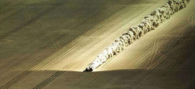

Rocket sleds routinely achieve high mach speeds. The Thrust SST was the first "official" human driven vehicle to exceed the speed of sound.
Rocket sled going 6453 mph:
Thrust SSC (sonic boom at 2:30 into video):
A bit after 1:00 in this video, you can see the shock wave impact on the ground of the approaching Thrust SSC:
Enhanced photo of the Thrust SSC shock wave in attached image:
