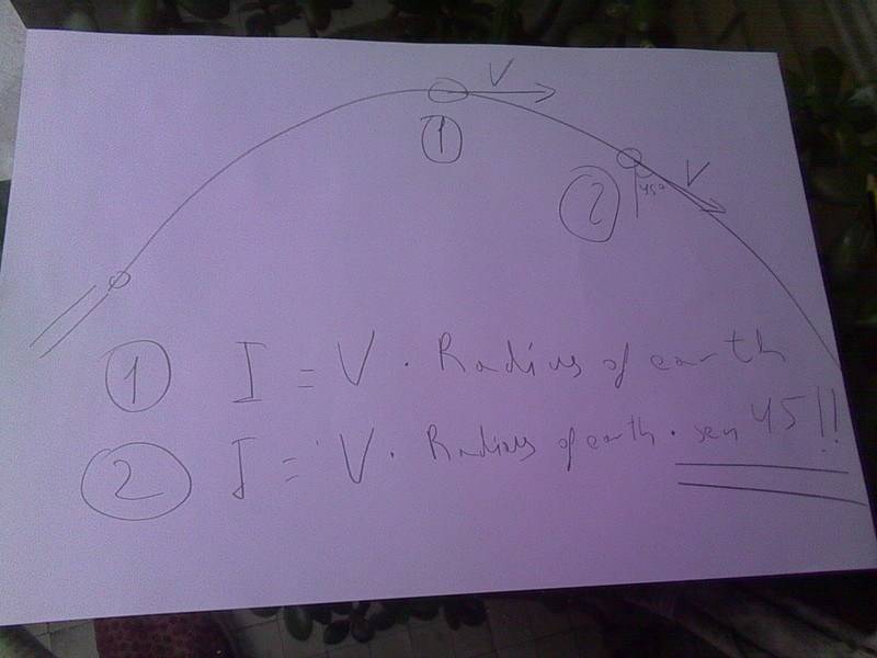

Parabolic shooting is a kind of orbit interrupted by the ground.
So I was wondering if I could calculate speeds of the bullet accounting for conservation of angular momentum.
Would this diagram be correct?
Why don't you try yourself to see if the result is compatible with the one obtained by using the laws of motion for projectile in uniform field?
Not really. A parabola comes from assuming a uniform gravitational force. When you talk about orbits you are talking instead about a central force. It would be the tip of an ellipse, not a parabola.
Edit: sorry @nasu I basically fed him the info you were trying to get him to discover.
