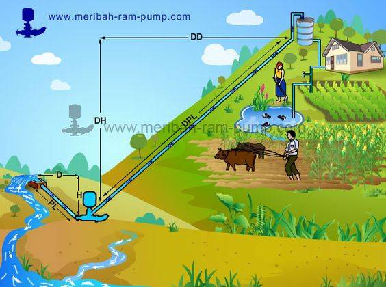

At the Ram pump you must have a solid fixing or concrete end-block at the bottom of the rising pipe. That block must counter two forces, the weight of the empty pipe, and the enclosed fluid pressure.
Empty pipe = weight of the pipe * Sin( slope angle).
The fluid = hydrostatic fluid pressure at bottom end of the pipe * cross-sectional area of the pipe.
The drive pipe must also be countered. But that is more tricky because of the pulse.
Assume the pressure in the drive pipe is the same as at the bottom of the riser pipe, because the valve opens during the pulse to connect the two pipes. Then compute the area of that pipe and multiply by that pressure.
In an ideal ram pump, the drive pipe will deliver in line with the output pipe so the pulse will not have to be countered in the pump mountings. But the continuous force in the riser must still be supported.
Remember for high lift ram pumps, the 10 metres of the driver pipe closest to the pump should be steel and not poly-pipe that will swell when the pulse occurs. The diameter of the entire driver pipe-line should be constant.

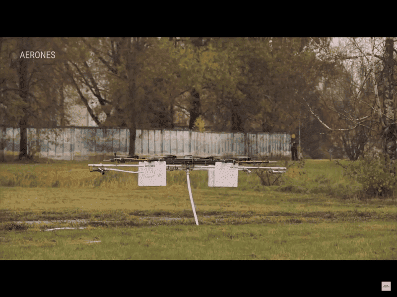

Thanks for that. Actually, I only gave that pic of a ram pump, just to show the more common scenario of the ground supporting the entire weight. A ram pump might be used in my scenario though.
But the key feature of my scenario is that the pipe is not lying along the ground but is freely extending into the air, with a support only at the top.
This video might give an idea of where I’m going with this and why I need to minimize the supported weight at the top:

RobertGC said:
This is a very different scenario than the one you first presented. The video gives some clues as to the forces involved. Again: start by drawing a diagram of it and labeling as many forces as you can see.
Not really. The pipe or hose is only supported at the top. For this drone, at a 200 kg lifting capacity, it’s powerful enough to support the entire weight of the water up to close to 1,000 ft and the weight of the hose.

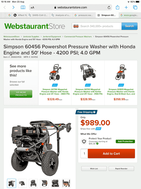

Yes. But consider this:
https://www.webstaurantstore.com/si...ne-and-50-hose-4200-psi-4-0-gpm/36660456.html
At about 10 times higher pressure at 4,200 psi get 10,000 ft(!) But then remember for a parabolic arc if you want to maximize horizontal distance given the same initial speed, or pressure, angle it at 45 degrees, then the horizontal distance will be twice as far, 20,000 ft, nearly 4 miles!
Obviously, at such very long distances you don’t want to support the weight of the water column, as it would take too much force. You want the water to travel that far due to its own pressure and velocity.
No way. I'm sure you've miscalculated; show us your calculations.
Also, the the dynamics of this are complicated. A pressurized hose is somewhat self-supporting.
