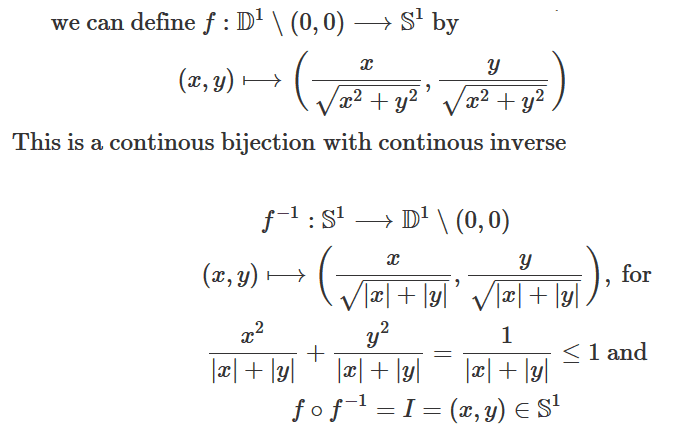

Please take a look at the image below

And what about ##f \circ f^{-1}##? The embedding of ##\mathbb{S}^1## into ##\mathbb{D}^1-\{(0,0)\}## isn't the problem and surely can be inverted. But is ##f^{-1}## surjective or ##f## injective? What is ##f(\frac{1}{\sqrt{8}},\frac{1}{\sqrt{8}})## and ##f(\frac{1}{\sqrt{32}},\frac{1}{\sqrt{32}})## which are both on the disc?

Do you mean ##f^{-1}##? I don't understand, these functions seems to map different points on ##\mathbb{S}^1##
EDIT: I got your point. Indeed those functions map two points of the disk into the same point of the circle. I didn't notice that when I was constructing the mappings.

I think what fresh is trying to say is that, e.g., ## (\frac{x}{\sqrt{x^2+y^2}}, \frac{y}{\sqrt{x^2+y^2}}) = (\frac {2x}{\sqrt{(2x)^2+(2y)^2}},\frac{2y}{\sqrt{(2x)^2+(2y)^2}} ) ## , since the 4's cancel each other out. The two spaces are homotopically-equivallent. Basically, your map crushes whole lines about the origin to a point, i.e., ## f(x)=f(kx) ##

Informally, what monkey and fresh said may be right, informally. When you go from a disk -(0,0) to a circle, you are " lowering the dimension" in the sense that you are crushing a whole (half-open) annulus into a point, the point on the boundary circle. The map ## x \rightarrow kx ## describes that. EDIT: Re dimensionality, notice that the disk -{pt} contains open 2-balls, while ##\mathbb S^1 ## does not.
