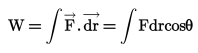

How can I find work done by variable force using F.dr When the equation of path is x=(2a) sinθ and y=(a) cosθ and F=(x^2) y i + x(y^2) j? If you can guide me how to write the integral relation so that I can calculate it, I would be grateful.
W=Int(F.dr)
Can anyone tell me if my answer is wrong ?!

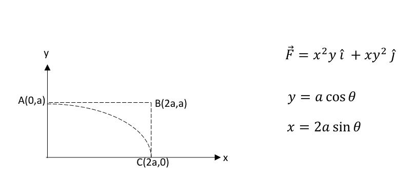

I was trying to write theta but I couldn't. I have sent a picture and in that picture x and y are functions of θ.
What is ##\theta## here? It can't be the argument parameter of the polar representation of (x,y) since we would deduce ##\tan^2(\theta)=\frac 12##. So I assume it is an arbitrary parameter unrelated to polar coordinates. But then, where do the integration bounds come from?
I see no diagram.

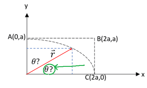

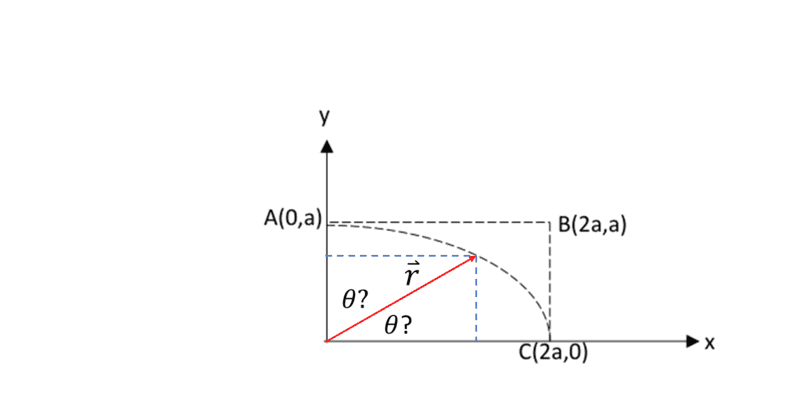

x and y are the equations of a part of an ellipse. We are going from a to c.

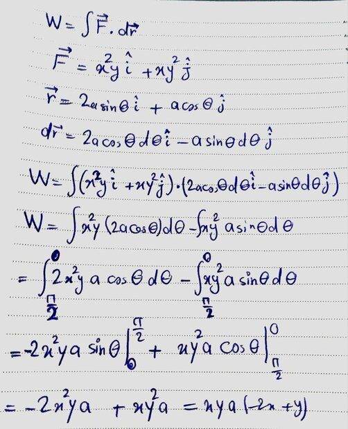

I have tried to use that integral but I failed and My teacher said that my answer is wrong again ...
He suggusted using polar coordinates to answer the question.
We can convert F to polar coordinates like this : https://www.physicsforums.com/threads/work-done-by-variable-force.1047266/post-6821666
Then we can find it's magnitude ...
Magnitude of dr is rdθ ...
But I don't know what is cosθ here... Can you please guide me about this ?!

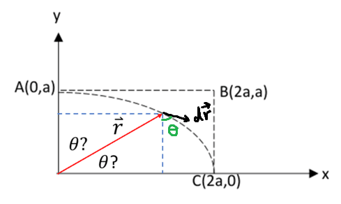

Draw a line from the origin to any point on the ellipse. Try to figure out what angle ( w.r.t the axes) ##\theta## must be such that the ##x## coordinate is given by ##2 a \sin \theta##.

## \vec r ## is the position vector. Which ##\theta## ( above ## \vec r ## or below it ) reconciles with ##x = 2 a \sin \theta## ?
MatinSAR said:
Thank you but what do you mean by this ?! I didn't understand.
This one should be Theta ...
Using that angle if you plug in ##\theta = 0 ## what does ##x## equal?
Theta=0 means x=0 and y=a
Does that seem correct to you?
According to the diagram no it's wrong ... so the other one is theta and I have chose the wrong one ...

Forget ##\theta## as a variable. Try this. You have $$x=2a\sin\theta~;~~2y=2a\cos\theta.$$It follows that $$x^2+4y^2=4a^2 \implies xdx+4ydy=0 \implies dx=-\frac{4y}{x}dy$$ Now $$\mathbf{F}\cdot d\mathbf{r}=(x^2y~\mathbf{\hat x}+xy^2~\mathbf{\hat y})\cdot(dx~\mathbf{\hat x}+dy~\mathbf{\hat y})
=x^2ydx+xy^2dy.$$ Substitute the expression for ##dx## and integrate over ##y##.
If you are going from A to C, the limits of integration are from ##\theta=0## to ##\theta = \frac{\pi}{2}##. From the equations for F and dr that I gave in post #16, what is the equation for F dotted with dr?
