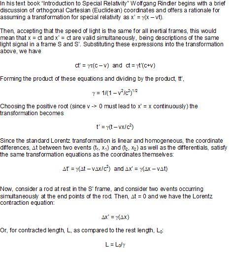

How about this one:

SR can be derived without the Light Postulate (i.e., without assuming the speed light is a universal constant in any inertial frame). But a lot more math ability is needed to grind through the derivation.
IOW, we merely introduce the concept of an inertial observer (who feels no acceleration, and can set up a Euclidean coordinate system). Then the Relativity Postulate -- that the laws of physics are identical in all inertial frames -- implies the Lorentz transformations (together with translations in space and time, and uniform dilations), together with the (possible) existence of a constant limiting speed, whose value must be determined experimentally.
But there's some serious math to grind through to get there.
In contrast, the Light Postulate simplifies the math considerably, hence tends to appear more often in textbooks.
So it's a bit of a tradeoff between the nonintuitive Light Postulate vs some heavy math using only the (imho, quite intuitive) Relativity Postulate.

That paper by Pal has a few problems/deficiencies. He relies early on rigid rods, etc, to get linear transformations. Such a motivation is only intuitive at ordinary lab scales, but less so on the very small and very large scales. Later, his argument about the sign of ##K = \pm 1/c^2## is rather weak. Also, for the argument to be complete, one should thoroughly analyze the properties of a body in the limit as its velocity relative to an observer approaches ##c##, and show that they coincide with observed properties of light.

There are, but in many ways they are more complex, less intuitive, and less directly connected to the physical situation that we're analyzing. Light signals show up in the physical derivations of the Lorentz transform because of Einstein's second postulate about the constancy of the speed of light.
So I think your question may be: Why are we so willing to accept this postulate?
There are two reasons:
1) It is supported by experiment and observation; it seems the world really does work this way.
2) The simplest interpretation of Maxwell's laws of electricity and magnetism suggest that electromagnetic radiation, aka light, should behave this way. (There are other ways of interpreting these equations, but they end up making additional assumptions and get more and more unwieldy as we try to reconcile them with experimental observations).
