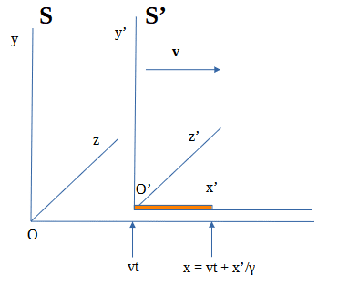

alan123hk said:
Is there the simplest, direct, and easy-to-understand method that only needs to apply the most basic algebra and logic to completely and strictly derive the Lorentz transformation?
  1. From the light clock scenatio, derive time dilation factor ##1/\gamma## and calculate ##\gamma=\frac{1}{\sqrt{1-v^2/c^2}}## with the Pythagorean theorem.
  2. Use this result and the standard twin paradox scenario to argue, that the length contraction factor must be ##1/\gamma##.
  3. Derive the Lorentz transformation from length contraction by using the following diagram.
Solve the shown equation for ##x'##:
$$x'=\gamma(x-vt)$$
With a symmetry argument, you get the inverse transformation:
$$x=\gamma(x'+vt')$$
Eliminate ##x'## between the two previous equations and then solve for ##t'## to get the time transformation:
$$t'=\gamma(t-\frac{v}{c^2}x)$$
$$t=\gamma(t'+\frac{v}{c^2}x')$$

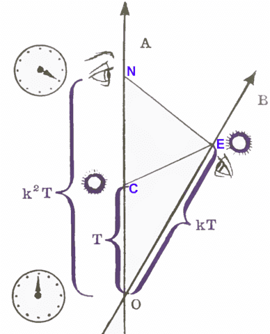

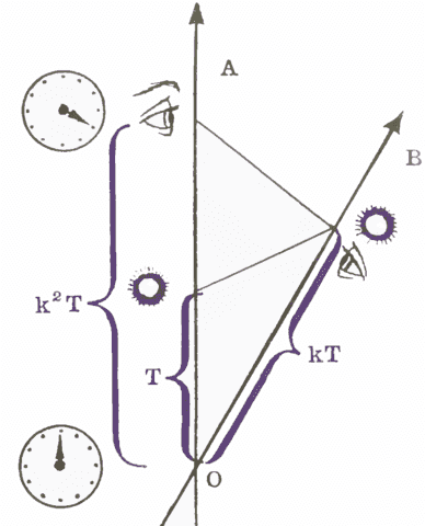

From what I have seen,
Bondi's "k-calculus" (which is an algebra-based method) is the simplest approach for introducing special relativity, with the emphasis kept on the relativity principle, the invariance of the speed of light, and spacetime geometry (on a position-vs-time graph)... motivated by operational definitions.
The usual Lorentz Transformation formula are seen as a secondary consequence of the approach.
(This is because Bondi works in the eigenbasis of the Lorentz boost transformation.
One has to re-write his equations in terms of rectangular coordinates to the more recognizable formula.)
Here is my Insight on this approach (providing more details that what Bondi presents to a general audience)
https://www.physicsforums.com/insights/relativity-using-bondi-k-calculus/ ,
which underlies my Relativity on Rotated Graph Paper approach.
The proper-times are related by
\begin{align}
\tau_{OE}& =k \tau_{OC}\\
\tau_{ON}& =k\tau_{OE}=k^2\tau_{OC}
\end{align}
where the relativity principle implies the same value of ##k##.
[##k## started out as just a proportionality constant for each observer,
but now are equal according to relativity
...it's more-familiar physical interpretation is uncovered later.]
These will be called the "radar coordinates of E (with origin at O)" ##u=\tau_{ON}## and ##v=\tau_{OC}##. (##v## is not a velocity.)
If you are just interested in the Lorentz Transformation,
you can skip some of these beginning subsections (intended for physical interpretation and connection with standard textbook formulas).
  • [To interpret in terms of rectangular coordinates...]
    The lab frame uses the "radar-method" to assign rectangular coordinates, where ##\tau_{OC}## is the clock-reading when the lab frame sends a light-signal to event E and ##\tau_{ON}## is the clock-reading when the lab frame receives a light-signal from event E \begin{align}
    \Delta t_{OE}&=\frac{1}{2}(\tau_{ON} + \tau_{OC})=\frac{1}{2}(k^2T + T)\\
    \Delta x_{OE}/c&=\frac{1}{2}(\tau_{ON} - \tau_{OC})=\frac{1}{2}(k^2T - T)
    \end{align}
    [This is arguably more-physical and more-practical for astronomical observations.
    (No long rulers into space are needed.
    No distant clocks at rest with respect to the observer are needed.)]
    (The first of this pair displays "time-dilation" when compared to ##\tau_{OE}=kT##.)
  • [To interpret ##k## terms of the relative velocity ##V##...]
    By division, we get a relation between the relative-velocity ##V## and ##k## (which turns out to be the Doppler formula)
    \begin{align}
    V_{OE}&=\frac{\Delta x_{OE}}{\Delta t_{OE}}=\frac{\frac{1}{2}c(k^2T – T)}{\frac{1}{2}(k^2T + T)}=\frac{k^2-1}{k^2+1}c
    \end{align}
  • [To recognize the square-interval in rectangular form...]
    Instead, by addition and subtraction,
    we get
    \begin{align}
    \tau_{ON} &=\Delta t_{OE}+\Delta x_{OE}/c=k^2T\\
    \tau_{OC} &=\Delta t_{OE}-\Delta x_{OE}/c=T
    \end{align}
    so we see that their product is invariant (to be called the "squared-interval of OE") and is equal to the square-of-the-proper-time along OE
    \begin{align}
    \tau_{ON} \tau_{OC} &=\Delta t_{OE}^2-(\Delta x_{OE}/c)^2=(kT)^2=\tau_{OE}^2
    \end{align}

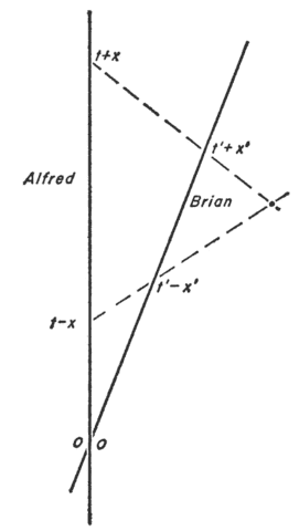

  • Again, with these "radar coordinates" ##u=\tau_{ON}## and ##v=\tau_{OC}##, we can locate event E. (Note: ##v## is not a velocity.)
    To obtain the Lorentz-Transformation and the Velocity-Transformation,
    introduce another observer (Brian) and compare the proper-times along Brian's worldline
    with what was obtained along the Lab Frame (Alfred): ##\tau_{ON}## and ##\tau_{OC}##.
    We can see that Alfred and Brian's radar-coordinates for event E are related by:
    \begin{align}
    u &= k_{AB} u'\\
    v' &= k_{BA} v.
    \end{align}
    By the relativity-principle, ##k_{AB}=k_{BA}##. So, call it ##K_{rel}##.
    Rewriting as
    \begin{align}
    u' &= \frac{1}{K_{rel}} \ u\\
    v' &= K_{rel} \ v,
    \end{align}
    we have the Lorentz Transformation in radar coordinates (i.e. in the eigenbasis).
    (Clearly, ##u'v'=uv##... displaying the invariance of the interval along OE.)
    No time-dilation factor ##\gamma=\frac{1}{\sqrt{1-(V/c)^2}}## or velocity ##V## is needed
    ... just the Doppler factor $K$.

When a signal is received, compare the sender's transmitted image of his clock at sending
with the receiver's clock there at receiving. The ratio of reception to emission is ##K##.
But they don't have to meet or zero their clocks.
Just send two signals... and work with differences.
  • Wow

Macdonald sets up a radar measurement and then presents this first numbered set of equations
\begin{eqnarray}
T+X =\gamma(1+v)(T'+X')\\
T-X =\gamma(1-v)(T'-X')
\end{eqnarray}
(with [itex]X'=0[/itex], [itex]X=vT[/itex], and [itex]T=\gamma T'[/itex]).
This is essentially Bondi's starting point,
"Eq 9 and 10" in my post above (which is a re-write of "Eq 1 and 2" in my post above).
[itex]T+X[/itex] and [itex]T-X[/itex] are light-cone coordinates, which can be re-written as radar-measurement times,
and
[itex]\gamma(1+v)[/itex] and [itex]\gamma(1-v)[/itex] are Doppler-Bondi factors [itex]k=\gamma(1+v)[/itex] and [itex]k^{-1}=\gamma(1-v)[/itex].
The pair of equations already contains the Lorentz Transformation (in light-cone coordinates).
By addition and subtraction, one gets the transformation in rectangular coordinates.
