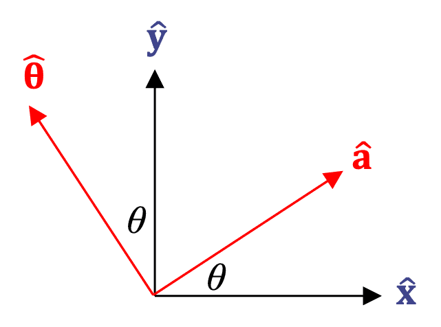

There is a more formal way to show the same thing which I prefer.
You have a vector ##\mathbf A## that has constant magnitude ##A## and direction ##\mathbf {\hat a}## that changes with time. You can write the vector as its constant magnitude times the unit vector specifying the direction, ##\mathbf A=A~\mathbf {\hat a}##. Now $$\frac{d\mathbf A}{dt}=A\frac{d\mathbf {\hat a}}{dt}.$$ To find the derivative of the unit vector ##\mathbf a##, consider the drawing on the right. A
unit vector in the direction of changing angle ##\theta## is perpendicular to ##\mathbf {\hat a}.## In terms of the fixed Cartesian unit vectors
$$\begin{align} & \mathbf {\hat a}=\cos\!\theta~\mathbf {\hat x}+\sin\!\theta~\mathbf {\hat y} \\
& \mathbf {\hat {\theta}}=-\sin\!\theta~\mathbf {\hat x}+\cos\!\theta~\mathbf {\hat y}
\end{align}$$Now from equation (1) $$\frac{d\mathbf {\hat a}}{dt}=\frac{d\theta}{dt}(-\sin\!\theta~\mathbf {\hat x}+\cos\!\theta~\mathbf {\hat y})=\frac{d\theta}{dt}\mathbf {\hat{\theta}}$$ and the time rate of change of the constant-magnitude vector ##\mathbf A## is $$\frac{d\mathbf A}{dt}=A\frac{d\mathbf {\hat a}}{dt}=A\frac{d\theta}{dt}\mathbf {\hat{\theta}}.$$
