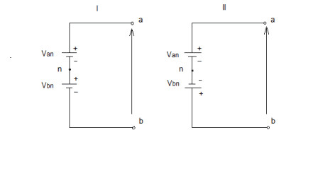

Why is Vab = Van -Vbn? I'm doing this after a while so maybe I'm getting something basic wrong but surely the potential difference between lines A and B is the voltage drop across phase a (Van) plus (rather than minus) the voltage drop across phase b (Vbn)?? So Vab = Van + Vbn?

Notice orientations of '+' poles of source voltages Van and Vbn as you go through the loop a-n-b-a

Ok let me illustrate this with DC circuits:
Can you see the difference between case I and II ?
Case I: Going from a to b is Van + Vbn ?
Case II: Going from a to b is Van - Vbn?
There is no difference. In either case the P.D. is given by the same equation.
Van is voltage at a referenced to n. Vbn is voltage at b referenced to n, that convention is clear.
So the P.D. is always Vab = Van - Vbn, and consistent with your output arrow direction.
Did you intend something different?
Arrow denotes voltage Vab (missing in the drawings). Vbn changes polarity so the outputs Vab aren't same in both circuits
