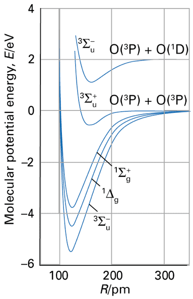

Hello! Is the isotope shift between 2 (low lying) vibrational levels of the lowest 2 electronic levels (of a diatomic molecule) the same, no matter what the 2 levels are? For example, is the isotope shift associated to the ##0 \to 0## vibrational transition of 2 molecular isotopes (here I mean the lowest vibrational level of the electronic ground state and the lowest vibrational level of the first excited electronic state) the same as the ##1 \to 1## isotope shift (here I mean the first excited vibrational level of the electronic ground state and the first excited vibrational level of the first excited electronic state)? And if they are not the same, how big (order of magnitude) is the difference? Any insight or suggested reading would be greatly appreciated. Thank you!

I think the principle is that the energies are separable, i.e. E_total = E_electronic + (n+1/2)hν (ignoring anharmonicity). But ν may, and generally does, vary from one electronic state to another, as the different electronic distribution affects the stiffness of bonds. Then
E(0→0) = ΔEe + 1/2 hΔν
E(1→1) = ΔEe + 3/2 hΔν
So E(0→0) is different from E(1→1) for the same isotopomer.
The isotope shift for E(0→0) will be 1/2 h(Δν1 - Δν2) = 1/2 hΔν1(1-μ12)
where the subscript 1 denotes the lighter isotopomer, and μ is the reduced mass, and for E(1→1) will be
3/2 hΔν1(1-μ12)

Certainly not!
Here is an example for Cs2
and this one for O2
These curves definitely correspond to very different bond stiffness, and thus different ##\nu##.
