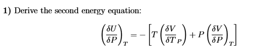

[itex](\frac{\partial U}{\partial P})_T[/itex] derivation
wololo
27
Typeset equation: (∂U/∂P)_T = -[T(∂V/∂T)_P + P(∂V/∂P)_T], with the heading '1) Derive the second energy equation:' above it.
Maxwell relations
Here is how I proceeded. Am I allowed to go from line 1 to 2? It almost seems too simple.
[tex] dU=TdS-PdV \\<br /> (\frac{\partial U}{\partial P})_T=T(\frac{\partial S}{\partial P})_T-P(\frac{\partial V}{\partial P})_T \\<br /> \text{We know that}-(\frac{\partial S}{\partial P})_T=(\frac{\partial V}{\partial T})_P \\<br /> (\frac{\partial U}{\partial P})_T=-T(\frac{\partial V}{\partial T})_P-P(\frac{\partial V}{\partial P})_T \\<br /> (\frac{\partial U}{\partial P})_T=-[T(\frac{\partial V}{\partial T})_P+P(\frac{\partial V}{\partial P})_T][/tex]
This seems fine, as long as you are allowed to use the "we know that" equation, which comes from the Maxwell relations.
