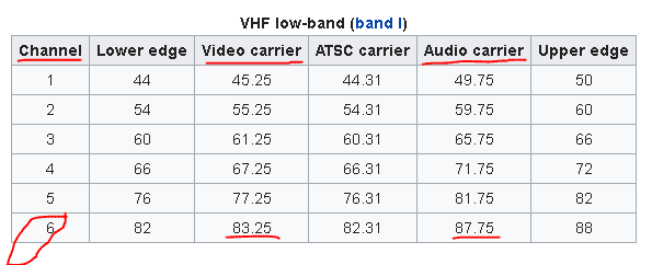

Another of my "boring anecdotes" ...
this one from the days of analog TV when i lived in Miami
A friend complained that his "shop radio" in the garage got one station all over the dial.
I went over for a listen and sure enough, in between stations WMIA at 93.9mhz boomed in.
I don't remember if the others were distorted but i think so...
Anyhow he was curious what might be wrong with the set...We figured it out. It was a fun mystery.
He lived within sight of Miami's Channel 6 TV transmitter, a powerful one on a 1400 ft tower.
Channel 6 uses frequency band 82-88 mhz which lies just below the FM band (88-108 mhz).
In analog days their audio carrier was at 87.75mhz and most digital tuned car radios would pick up channel 6's sound when set for lowest frequency, 87.9 .
That was handy , you could listen to their news while driving to work.
Hmmm. Look at that channel 6 video carrier...
We noticed that the intruding station at 93.9, and channel 6's video carrier at 83.25, differ by 10.65 mhz.
We both knew that FM receivers have IF frequency typically 10.7 to 10.8 mhz.
The plot thickened.
We asked ourselves: "If Superheterodyne works, why not also SUB-heterodyne?"
That led to the questions :
" Who said your local oscillator has to be inside the radio? "
"Is that channel 6 video carrier booming in here, overdriving the first stage, causing it and WMIA to make a difference frequency that's in the receiver's IF passband?"
"Standard FM modulation is ±75khz so it's plausible that a 10.65mhz difference signal would get through a 10.7 IF ... "
"Maybe this particular set's IF is tuned to 10.70 and 10.65 sneaks in, or maybe the set's IF got tuned just a teeny bit low at the factory..."
Sure enough the local TV shop had a couple dollar "channel 6 trap" for the antenna lead-in, and that fixed it.
We called it "The case of the not-so-local oscillator". old jim
