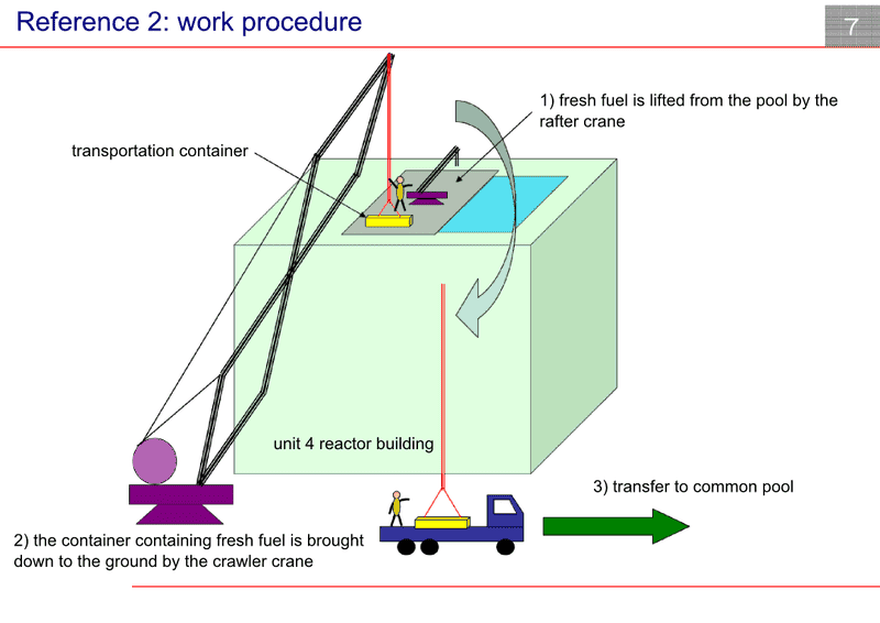

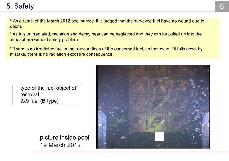

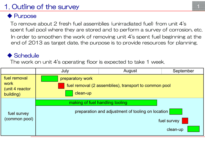

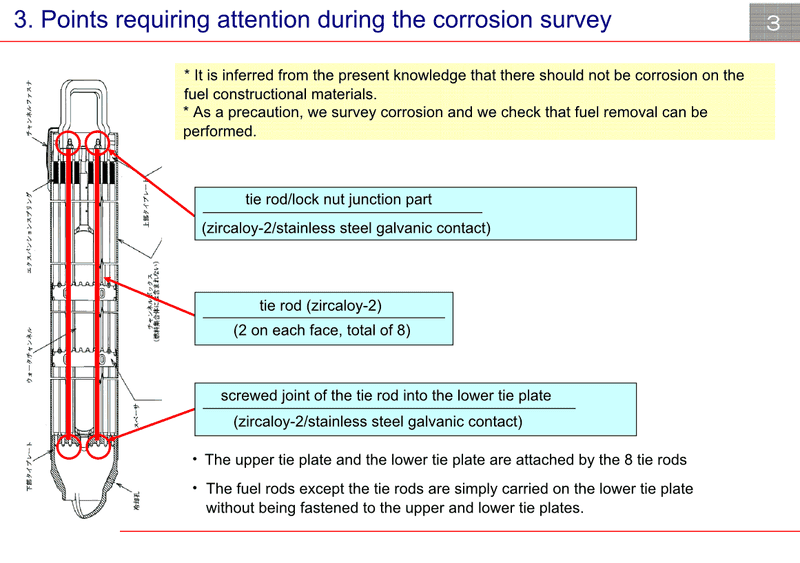

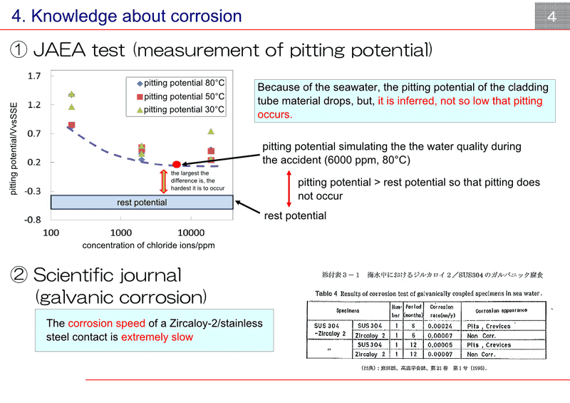

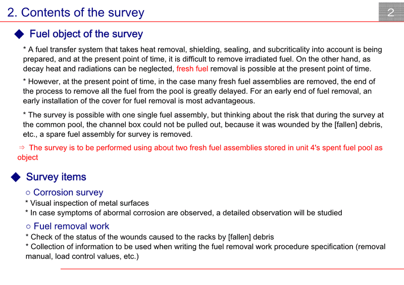

  • #13,417
Unit 4 SFP (was...)
biggerten said:
Perhaps they're trying to avoid suggesting that that is the particular rack in question. In other words, the picture is an example, but they may pick a different rack - it seems they don't know for sure how many they are going to sample, even.
I think they have been clear about their intention to remove 2 new fuel assemblies from a rack, and to remove them from positions where an unintentional drop during the operation has low probability of damaging close by spent fuel assemblies. It is not credible that they haven't picked their favoured target positions.

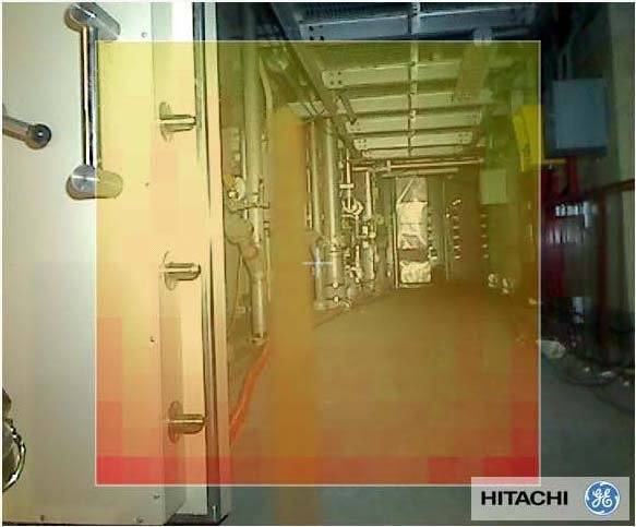

  • #13,420

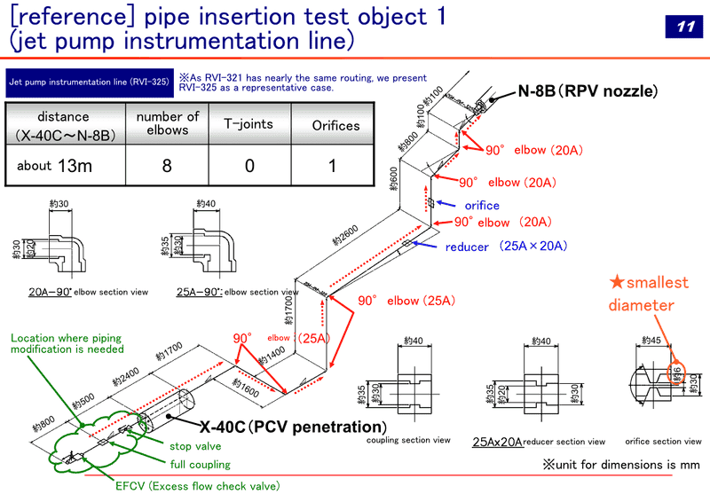

Reactor 3 TIP room investigation
SteveElbows said:
I see the reactor 3 TIP room investigation was a bit of a failure, due to door etc debris.
http://www.tepco.co.jp/en/nu/fukushima-np/images/handouts_120524_06-e.pdf
Given that a human was able to visually inspect one part of the room, I am less than impressed about a lack of photo of this area. It makes me curious about the nature of any debris inside the room.
Now I wonder what that recent investigation was really about. Tepco would have known for more than a year, since the first robot expedition to the area, that the entrance to the TIP room was blocked, so that a robot would not be able to enter. Indeed the new video indicates that a large object close to the entrance to the TIP room has been moved, so there have been humans at the spot too since then. So why make an effort to 'rediscover' that the entrance is blocked, rather than make an effort to unblock it -- which would seem the rational thing to do, if one _really_ would like to inspect the room? And as you mention, weirdly there is apparently not even a photo of the room to show from the latest mission. Was it all just a stunt?

This is a document from one month ago :
tsutsuji said:
The 5th mid long term meeting : http://www.meti.go.jp/earthquake/nuclear/20120423_02.html
3-1 Cooling by closed loop water injection
http://www.meti.go.jp/earthquake/nuclear/pdf/120423/120423_02g.pdf Report on the results of mock-up tests for the purpose of installing alternative RPV thermometers
( See also my translation of the 1 March 2012 report on the same topic (alternative thermometer insertion) : https://www.physicsforums.com/showpost.php?p=3795578&postcount=12465 part 1, https://www.physicsforums.com/showpost.php?p=3796935&postcount=12485 part 2, https://www.physicsforums.com/showpost.php?p=3799356&postcount=12492 part 3)
Translation:
1/12
2/12
3/12
  • #13,422
Translation:
4/12
5/12
6/12
  • #13,423
Translation:
7/12
8/12
9/12
  • #13,424
Translation:
10/12
11/12
12/12

  • #13,426
Assuming the TIP room door was hinged normally at the time of the earthquake, how would it have been possible to have the door closed,
considering Tepco apparently for some reason had placed a reddish beam along the ceiling protruding out through the doorway?

I also don't understand this TIP room story.
First they say the door is closed, then they suddenly discover that it is blown away. How come?

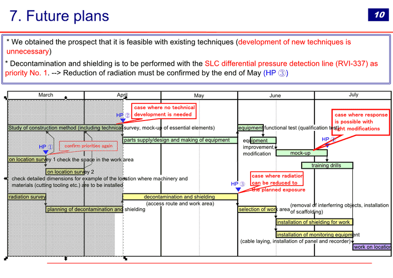

  • #13,430
tsutsuji said:
The 6th mid long term meeting was held yesterday: http://www.meti.go.jp/earthquake/nuclear/20120528_02.html
28 May 2012 government-Tokyo Electric mid and long term response committee, steering committee (6th meeting)
http://www.meti.go.jp/earthquake/nuclear/pdf/120528/120528_02h.pdf Results of the surveys on location concerning the environment improvement for the purpose of installing alternative thermometers in unit 2's RPV.
See also on the same topic (alternative thermometer insertion) : my translation of the 1 March 2012 report ( https://www.physicsforums.com/showpost.php?p=3795578&postcount=12465 part 1, https://www.physicsforums.com/showpost.php?p=3796935&postcount=12485 part 2, https://www.physicsforums.com/showpost.php?p=3799356&postcount=12492 part 3) and of the 23 April report just above ( https://www.physicsforums.com/showthread.php?p=3939578#post3939578 )
See also the videos:
http://photo.tepco.co.jp/en/date/2012/201206-e/120601_02e.html "Decontamination around the truck bay door at Unit 2, Fukushima Daiichi NPS" (released on 1 June 2012)
http://photo.tepco.co.jp/en/date/2012/201206-e/120601_01e.html "Mock-up test to check the insertability of the alternative thermometer at Unit 2" (released on 1 June 2012)
Translation:
1/10
2/10
3/10
  • #13,431
Translation:
4/10
5/10
6/10
  • #13,432
Translation:
7/10
8/10
9/10
  • #13,433
Translation:
10/10

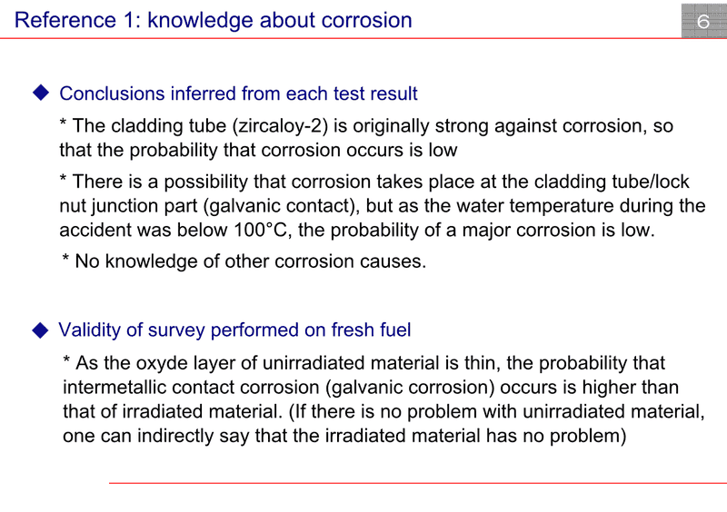

http://www.tepco.co.jp/en/nu/fukushima-np/images/handouts_120605_03-e.pdf "Unit 4 Spent Fuel Pool Alternative Cooling System Secondary System Circulation Pump (A) Situation of the Burnt Area Near the Motor Terminal Housing"
http://www.tepco.co.jp/nu/fukushima-np/images/handouts_120605_04-j.pdf At 20:03 on 4 June unit 4 SFP had an "airfin cooler panel alarm" ringing, and it was found that secondary circuit pump A had tripped with some traces of burning on the pump's terminal box. Pump B was started at 20:27. At 10:30 on 5 June, pump B was shut down in order to perform an inspection. As the pool temperature is expected to rise by 0.3 °C/hour, this is not considered as being a problem for pool temperature control.
