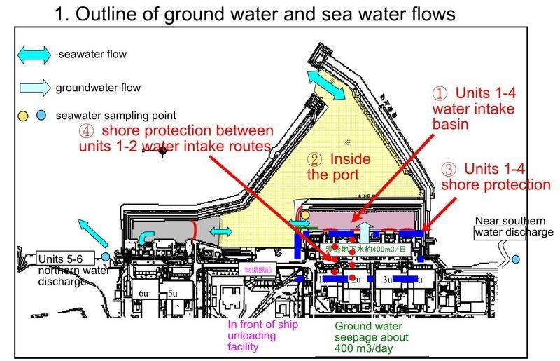

When following the various events and "informations" about this disaster since the very beginning, it's astounding to try to list the number of "inconsistencies" (or lies?) that have been explained by the various actors, Tepco being the number one but the government being a close number two...
Two examples:
-Tepco revised recently their assessment of the daily volume of groundwater flowing into the plant from the mountains, the volume that they had to pump and consequently the volume of contaminated groundwater that flows everyday directly to the sea: 800 m3 should come from the mountains, 400m3 are pumped and stored, and 400m3 would consequently flow directly to te sea. Well. The problem is that Tepco also confirmed that before the accident, they were pumping between 850 and 1200m on a daily basis to avoid inputs of groundwater inside the basements of the buildings because of the way the plant was erected: the 30m hill above see level was transformed to the platform 10m high that we know (probably to lower the energy required to pump in the seawater used for cooling the reactors, making it vulnerable to high amplitude tsunamis as we know). So how could it be 800 m3 today if the volume pumped before the accident was already 850 to 1200 m3?
- Tepco apparently confirmed recently that reactors 5 and 6 are pumping 6000 m3 every hour to cool the reactors INTO THE PORT, and rejecting them OUTSIDE OF THE PORT... Tsutsuji, could you confirm this info from the links given here (in japanese)?
http://fukushima-diary.com/2013/09/...ima-port-to-discharge-to-outside-of-the-port/
If true, how can it be possible (we know it's not!) to say that contaminated water is enclosed into the port (Tepco didn't say it, but Abe did!) ??
EDIT: the link to this document from August 2013 is said to refer to a coolant volume à 7000 m3/h (which is huge?) for 5 and 6 but i didn't find the data in the document (i don't read japanese, even if numbers are the same!). But page 58 seem to show a map with arrows to represent the various flows, but i don't understand all the details (is there a kind of dam between side of the port toward reactors 5 and 6 and the other ones, like this red line between the two sides of the port seems to suggest?)

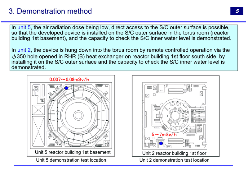

The "about 6000 m³/hour" data can be found in the press conference transcript at http://genpatsu-watch.blogspot.com/2013/09/20139261730-8.html below timing 00:54:55 when Mr Ono replies to a question about the unit 5-6 silt fence breakup.
The 7000 m³/h data is from page 60 of the following document :
http://www.tepco.co.jp/nu/fukushima-np/handouts/2013/images/handouts_130821_10-j.pdf
Page 58/78
Again, great thank you Tsutsuji for the confirmations and the translation of the map!
So do others here come to the conclusion that through the pumping of 6000/7000 m3/h into the port for cooling reactors 5 and 6, there is inevitably contamination that is therefore rejected directly into the sea at the point of the extreme left blue arrow on the map? It may be one of the reasons why they have erected this wall with tubes along reactors 1 to 4...
As I recall the regular checking of seawater does not show much contamination there.
I don't see how water in the port can be prevented from mixing with the ocean. The tides move water in and out regularly, right?

Regarding the pumping rate to Units 5 and 6, I have a naive question (actually a sanity check). 6,000 m3 an hour? That's 6,000 tons (or to use a "unit" favoured by the BBC just over 2 olympic swimming pools) an hour. I thought units 1 - 4 were only adding 500 t a day to the water storage and therefore only consuming that amount. Is that a typo by Tepco?
I am afraid you are comparing data that cover different things.
The 6000 m3/hour of seawater cover the cooling of both the cores and the spent fuel pools of units 5 and 6, using thermal exchangers to cool fresh water in the secondary circuits. The flow rate in each secondary circuit must be a fraction of those 6000 m3/hour, depending on the efficiency of each thermal exchanger.
The water added to storage is quite unrelated to the amount poured into the reactors. The water added to storage is mostly related to the ground water level and the size of the cracks in the basement walls, through which ground water infiltrates into basements.
See no major technical problems in the implementation plan for the complete closure of the port. It would be a desire, facilities exist.
Another thing that completely closing the port they turn it into a radioactive lake.
But the little Japanese trick, an additional net inflow and outflow of dirty water
Surely that is somewhat tendentious.
The huge cooling flow for reactors 5 and 6 is purely for heat management, the sea water that comes in is not contaminated, only heated a few degrees and flushed out. As Tsutsuji-san pointed out, it is processed through a secondary heat exchanger and never gets into the reactor.
The flows into (and out of) reactors 1-4 are quite different, mostly because they are makeshifts to keep damaged reactors cool. Obviously the flow paths are wrong, else we would not be having steam bubbling up from the wreck of reactor 3 while pouring in hundreds of tons of water per hour. Unfortunately, it is as good as we can do with the damaged structure that we have.
Imho, it is only through a miracle of Japanese grit that this disaster did not get much worse. We can be grateful that the long term contamination will be moderate, sort of as if Tokyo was shifted to Denver. Clearly the Japanese government is prevaricating about those effects, but it is unworthy of you to speak of 'little Japanese trick'. The actual work done is very impressive.
I'm sorry if hurt you.
Devil's translator,I say it's cunning, it's not trick.
Water from the port (a dirty place) falls into the ocean through the reactors 5 and 6. (In this case the heat exchanger reactors is a cleaner place.)
Thus speeding up the inflow of clean water out of the sea through the main gate of the port.
Not hurt, more surprised. As the coolant intakes were always there, it seems incorrect to speak of a 'trick' now.
Your point about the port flushing action of this flow is well taken however. It, along with the volume of ground water, is another murky element in determining the actual contaminant flows from the site.
