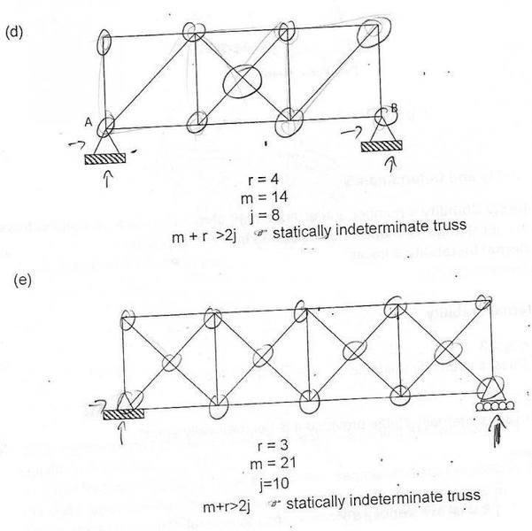

in the notes, r =number of reactions, m = number of truss members , j = number of joints
i suspect that the j for d and e are wrong...
I have circled the joints and calculated them, for d , j= 9,
for part e , it should be j= 14,
Am I right?[/B]

The x braces might or might not be connected where they cross, although usually connecting them helps out of plane bucking for compression members. Either way, the brace forces are the same, so you need not count those joints when determining degree of indeterminacy. The author didn't pick a good example in my opinion.
