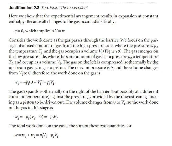

A gas flows along an insulated pipe (q=0) through a porous plate that separates two sections of the pipe at different constant pressures P1 and P2.
In Thermodynamics we study systems at equilibrium but here the gas is not in equilibrium because there is a pressure difference across the porous plate.If this were not the case, the pistons would accelerate and the pressures would change with time. The pistons are externally constrained so that P1 and P2 are held constant.
I read that gases flow from high pressure to lower pressure to equalize pressure. If gas flows from the left chamber to the right chamber through the porous plate, wouldnt this initially cause the gas pressure in the left chamber to drop so that $$ P_{gas,left}<P_{1} $$ causing the left piston to move inward and compress the gas until the pressure is restored to P1? Similarly, gas entering the right chamber would tend to increase the pressure so that $$ P_{gas, right}>P_{2} $$ causing the right piston to move outward and expand the volume until the pressure returns to P2. After this adjustment, there would still be a pressure difference between the left and right chambers. Does this mean that piston motion continues indefinitely, eventually pushing all the gas from the left chamber through the porous plate so that all the gas ends up on the right side?

I am quite confused by the way my textbook presents the Joule–Thomson experiment. A gas flowing through a throttling valve from a high pressure Pi to a lower pressure Pf is an open system. However, the book treats the gas as if it were a closed system and imagines the upstream side acting like a piston compressing the gas at pressure Pi, while a downstream piston resists at pressure Pf.
Is the book effectively tracking a small mass of gas that passes through the valve, such that at some time the mass occupies a region upstream and the surrounding upstream fluid (represented by the left piston) pushes it into and through the valve? Later, the same mass occupies a region downstream, so relative to that moving mass the surrounding fluid or the left pistonsweeps across the region it previously occupied.
How does this viewpoint justify the use of the closed-system first law?
Is fluid pushing fluid mechanically equivalent to a piston applying the same pressure in a piston–cylinder process?
The first law of thermodynamics, written in the form ##U_2 - U_1 = W + Q## , only applies to a closed system. That's why we isolate a closed system at a given instant and track it over time.
In the explanation provided, the closed system contains the porous zone that maintains the pressure gradient.
You can imagine two (immaterial) walls that delimit this closed system upstream and downstream. The external gas exerts pressure on the walls. Upstream, it pushes, and downstream, it resists.
Now, imagine the gas moving forward. The two walls move simultaneously with the gas. If the upstream wall has swept through the volume ##V_i##, the work done is ##P_i V_i##. The work done downstream is ##-P_f V_f##. The work done is the same as if there were pistons.
Since there is no heat exchange, the first law of thermodynamics can be written as: $$U_2 -U_1 = P_i V_i - P_f V_f$$ But if you look at how the closed system has evolved, you see that the central part has not changed because we are in steady state (The fluid flows continuously, but it remains in the same state in this central region).

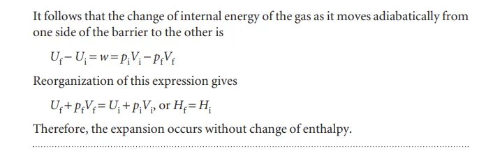

If we denote ##U_c## the internal energy of the central part, we have: ##U_2=U_c+U_s## and ##U_1=U_c+U_i## if we denote ##U_i## the internal energy of the gas which, upstream, had the volume ##V_i## and ##U_f## the internal energy of the gas which, downstream, had the volume ##V_f##. $$U_2 -U_1 = U_f -U_i$$
In the end, we are left with: $$U_f -U_i=P_i V_i - P_f V_f$$ or:
$$U_f +P_f V_f=U_i+P_i V_i $$ or, with enthalpy: $$H_f=H_i$$
In this expression, ##H_f## is the enthalpy of the downstream gas of volume ##V_f## and ##H_i## is the enthalpy of the upstream gas of volume ##V_i##.
Since the mass flow rate is constant (steady state), the mass corresponding to ##V_f## and ##V_i## are identical, equal to ##M##. You can therefore divide by this common mass, and we obtain that the upstream specific enthalpy is equal to the downstream specific enthalpy.
Note that this reasoning can sometimes be a little confusing because the fluid considered upstream and downstream is not the same. However, when defining specific enthalpy, it's simply a matter of taking a quantity of fluid and dividing by its mass.
Also note that if you want to track a closed mass of fluid passing through the porous region, it will initially occupy the volume ##V_i## and have the enthalpy ##H_i## . Then it will pass through the porous region and many complicated things will happen to it. Finally, after a certain time, it will emerge and occupy the volume ##V_f## with the enthalpy ##H_f=H_i##: so in the end, a closed mass of fluid does indeed have the same enthalpy at the start and at the finish.
