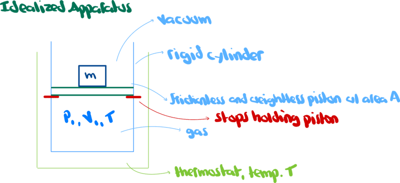

Here is the reasoning as it appears in the book.
Consider the following setup
Work (w) is a scalar quantity defined ##w=\vec{f}\cdot\vec{L}##.
where ##\vec{f}## is the vector force and ##\vec{L}## is the vector length of path.
If the force vector of magnitude ##\lVert \vec{f}\rVert## and the vector length of magnitude ##\lVert \vec{L} \rVert## are separated by an angle ##\theta##, the work is given by ##\lVert\vec{f}\rVert\lVert\vec{L}\rVert\cos{\theta}##.
Pressure, ##P## is force per unit area, ie ##P=\frac{\lVert \vec{f}\rVert} {\lVert\vec{A}\rVert}##.
Consider a situation where the gas in the cylinder above is expanding, pushing the piston upward.
The differential quantity of work done by the expanding gas to move the piston a distance ##dL## is, according to the book
$$w=\lVert P\vec{A}\rVert dL=PdV\tag{1}$$

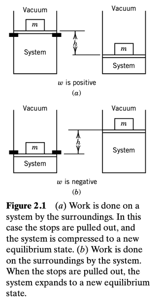

The book has this depiction
As far as I can tell,
in (a), the force applied by the piston on the gas (which is the same as the force applied by the mass onto the piston, since the latter has zero mass and there is no friction with the cylinder) is in the same direction as the displacement vector of the gas. This is the same work done by the force of the mass on the piston and is positive.
in (b), the force applied by the piston on the gas is in the opposite direction to the displacement of the gas, and so the work done by this force is negative.
Now, the convention says that in (a) work is "done on the system" and in (b) work is "done on the surroundings", and also that $$dw=-P_{ext}dV$$.

Here is another simple example I don't quite understand
Suppose we have the situation depicted in the picture of the original post.
We pull the stops out and the piston falls to an equilibrium position at a volume ##V_2## and a pressure ##P_2##.
Says the book,
The pressure of the gas at the end of the process is given by ##P_2=\frac{mg}{A}## where ##g## is the acceleration due to gravity, and ##A## is the area of the piston. The amount of work lost in the surroundings is ##mgh##, where ##h## is the difference in height, and so the work done on the gas is
$$w=mgh=-P_2(V_2-V_1)$$
Since ##V_2<V_1## the work done on the gas is positive.
I understand why the work is ##mgh##: the weight of the mass is ##mg## and this is the force being applied over the area ##A## that is the piston and this is transmitted to the gas in the cylinder.
This is positive because the weight of the mass is pointed down and the displacement is also pointed down. The dot product is positive.
What I don't get is the expression ##-P_{ext}dV=-P_2(V_2-V_1)##.
As I explain in the original post, we start with a dot product ##P\lVert \vec{A}\rVert \lVert dL\rVert\cos{\theta}##. Now ##\lVert \vec{A}\rVert \lVert dL\rVert## is a volume, and the cosine gives us the positive/negative sign (since we are considering our force being perpendicular to the area to which it is applied). What are we calling ##dV## and how do we think about the sign convention (ie, the negative sign that is introduced)?
